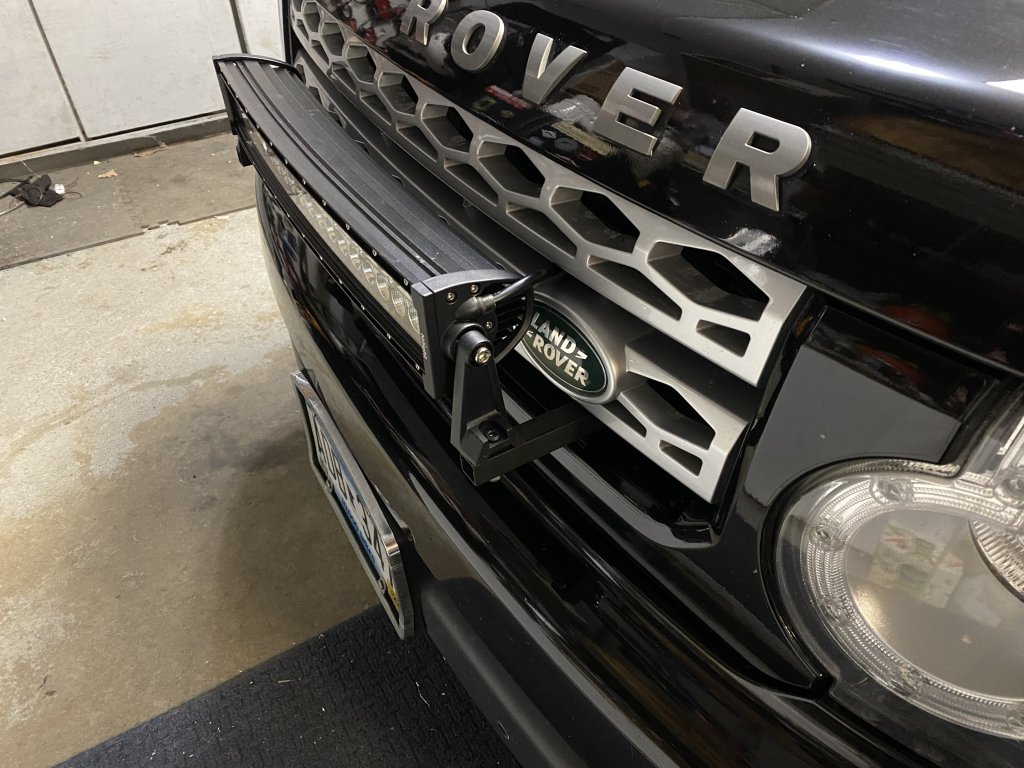

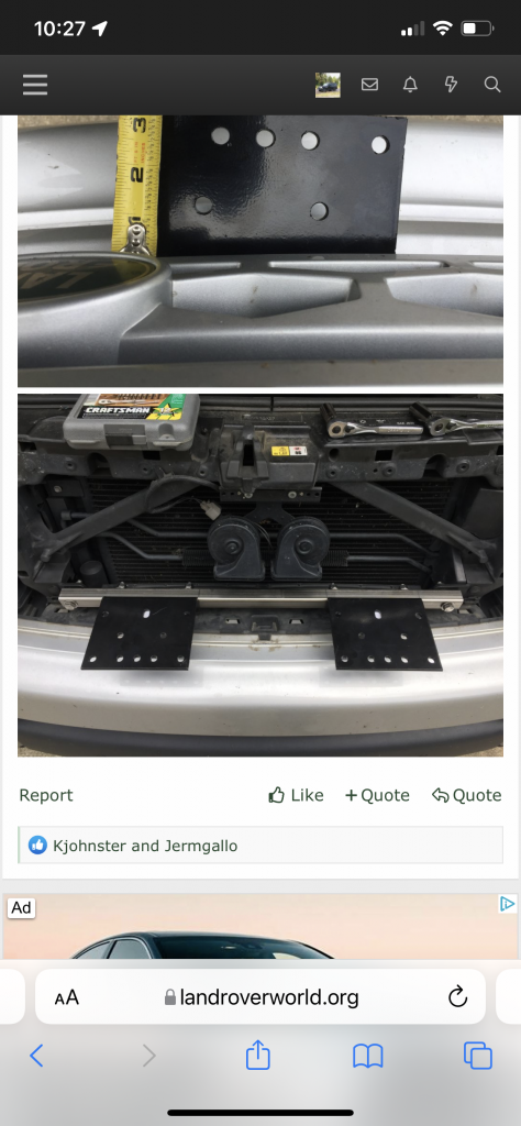

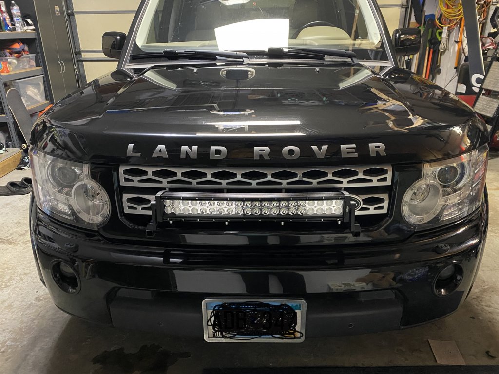

Finally installed a 24” curved light bar using aluminum square tubing.. I tied it into the lower driving light wiring following a different thread on our forum. The light needs to be removed in order to remove the grill but I don’t plan on doing it much unless the headlight assemblies need attention.. very happy so far!! I also followed another thread installing the aluminum tubing below the dual horns..
