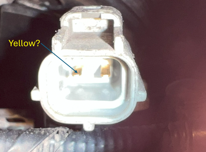

Yes I think so, it's the same sensor that was previously complaining about a circuit issue. For some reason it seems to be measuring hot when it's not; the pipe wasn't even hot to the touch. Perhaps the wires are the wrong way around? Could somebody look to see if the yellow wire is connected to the left side of the plug as indicated below (image rotated for clarity)?
I hope it's yellow - I'm colorblind; the other color (red or green) is connected to the right pin, so like this (before I did the splice):

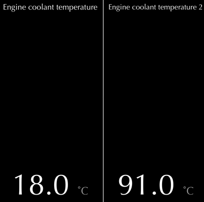

It is the front sensor, just below the thermostat that I replaced. The engine was cold, this was the first start of the day. The temperature on the dash is showing normal. When up to temperature I got these temps (swapped from previous positions):

What were your readings with ignition on/engine off? Did they look OK? The warm readings look good.

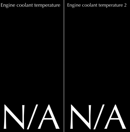

I reread the temperatures, this is ignition on/engine off, initially I got this (which I suspect is why I aborted this the first time):

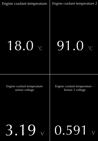

Rather than going to quick list I went to the full list and was able to read the following (the engine hasn't been started today):
I then realized I could get voltages as well (ouch!):

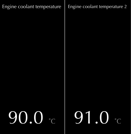

With engine running and the engine speed having dropped from initial high revs (so approx. a minute) I get this:
