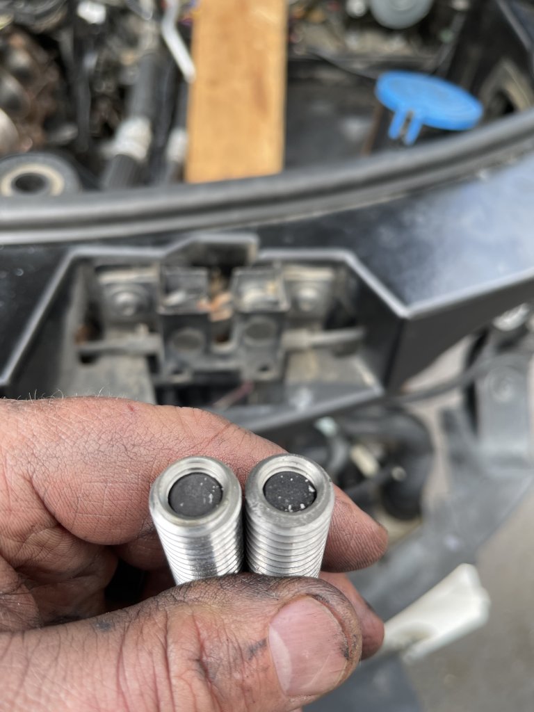

Quick service announcement: For those that choose to install head studs. You can't remove the head with the studs in the block. But, assuming they'll back out, you can unscrew the studs and pull the studs/head at the same time. Or, in my case, the studs and steel inserts at the same time. (Totally figured that out on the 2nd head....not the first. SMH).
I will say this. I was worried about having the correct stud length, and the length was perfect!!! I still had 1/2"-3/4" of thread left on the head side, and the block side was fully seated into the insert! For those of you counting, that's roughly 3 times the grabbing force than just a stock head bolt in the Aluminum.
What you're seeing is the bottom of the insert....and they're about 1.5" long...give or take.

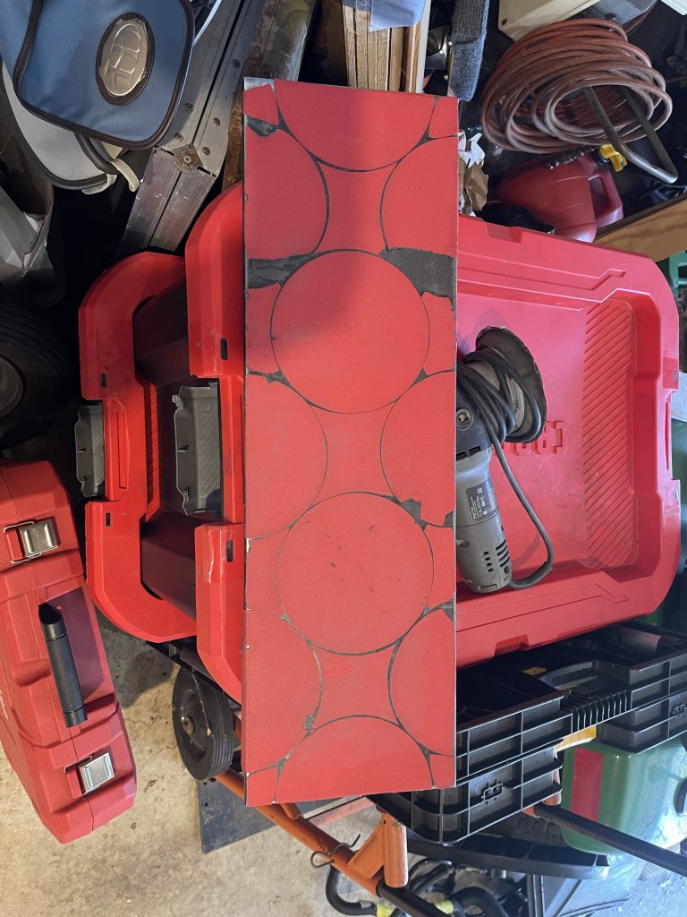

OK, so I finally got a little work done this past weekend. It took me roughly a day or so to get my deck prepping tool made...and that was mostly because it took the JB weld that long to set up.
Basically, as I don't have the tools on me to pull the block back out, I'm "decking" it in the engine bay. Not my preferred method, but hopefully it'll be enough. I only finished one side this past weekend, and probably sanded for roughly 2 hours.

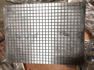

My tool...or tools of choice are a large piece of flat stock still I bought from a welding shop for $40. then, I picked up a cast iron lapping plate from eBay and had my machine shop actually surface it.
Here's the cast iron lapping plate:

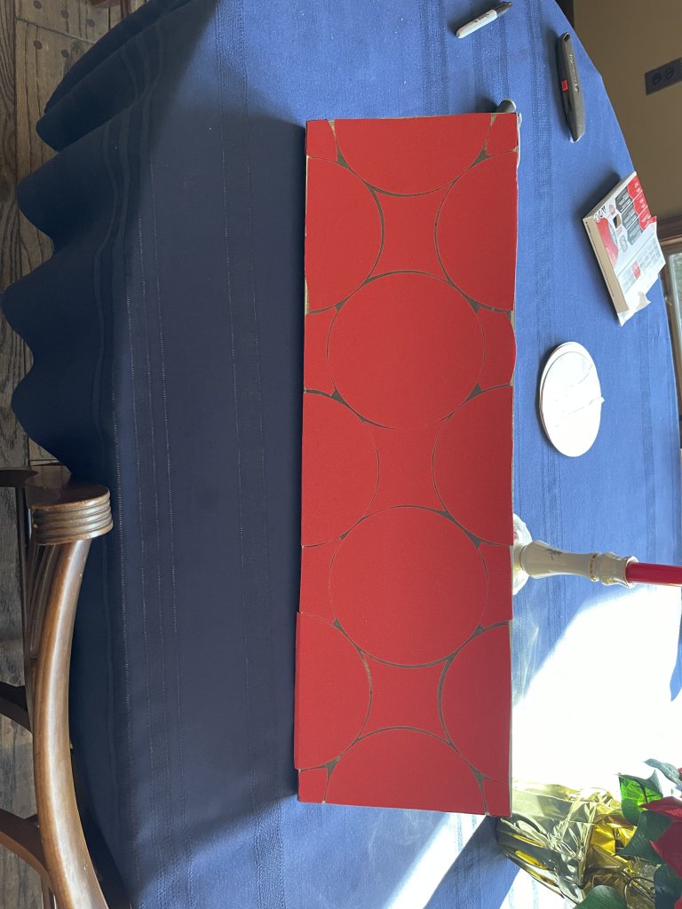

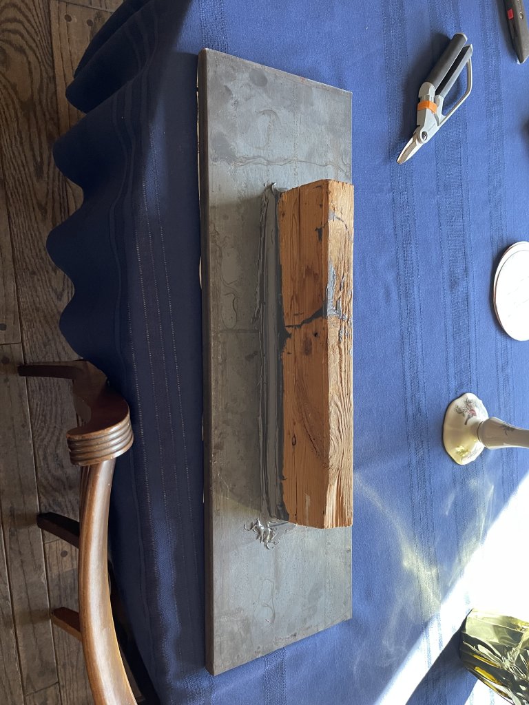

I tried to sand the steel stock as flat as I could, and it's probably within .01" of being flat...but it's flat enough as long as you keep it moving and switch directions and what not. I JB welded a piece of 2x4 to the steel so I'd have a handle, then used stick on sanding discs underneath. Usually, I just use sand paper with adhesive, but this was faster, less messy, and after talking with a master machinist, he recommended the "multi disc" setup as it allows "channels" for the particulate to move off the sanding surface into. I used 120 grit discs, but have 80 and 40 just in case. (Full disclosure, I got the 40 grit to tackle the steel plate).
Here's what I came up with:
All in all I have to say it worked better than I thought it would. It took roughly 2 hours to sand it down as far as I wanted...and by 2 hours, I mean probably like 1 hour of sanding and 1 hour of resting cause that plate weighs like 80lbs and sliding it around was not easy!
Using a straight edge and feeler gauge, everything was flatter than .0016", which is better than the .002" variance I was hoping to achieve. Now, I only did the one side as I was tired, and I had to move the fuel lines and starter power wires from the other side to give me enough room to fully slide the plate across the block. After I sand the other side, I'll use coarse (120 grit) and then fine (220 grit) lapping compounds to polish the surface even further...and hopefully get it just "that" much flatter.

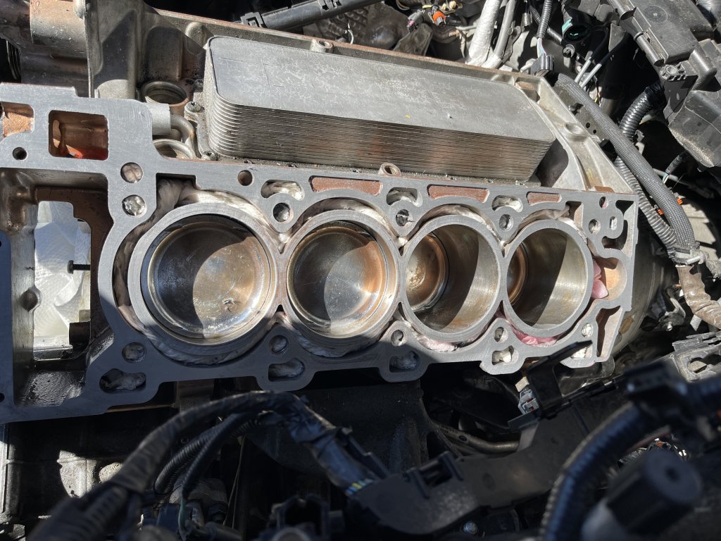

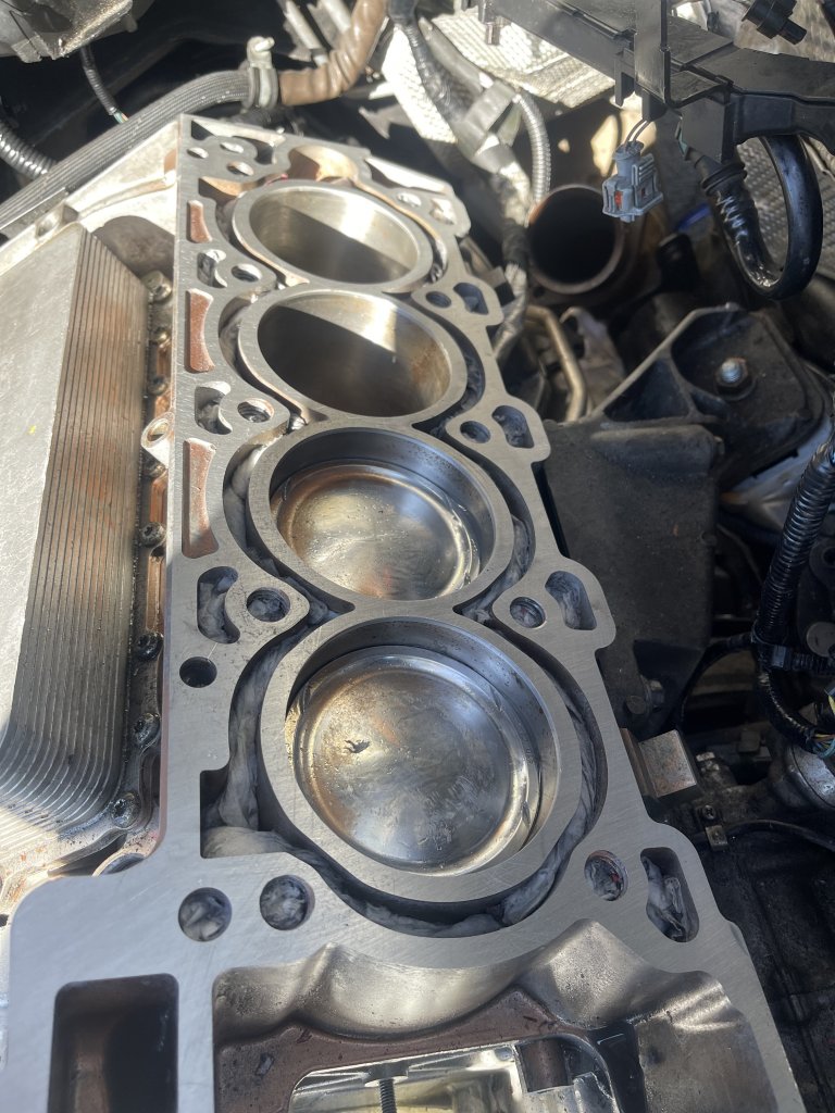

Here's a pick after the first 15 minutes of sanding, you can still see portions of cylinders 2, 4 and 6 are still low:
Finally finished sanding, just a little "staining" on the outer edge of 4 and 6, but it checked flat so I'm calling it good enough!
