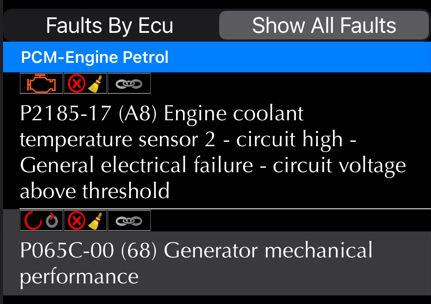

Too late but I don't think it was feasible anyway... Still, something isn't right as I got these fault codes :-(. The good news is that the engine is running and seems to be OK, although it's still early days.
P2185-17 and P065C-00; the first is the sensor, the second perhaps an issue with the changing system? I have an engine light on I suspect it's for the first issue... I did see the charging system fault but that disappeared.
Given the damage to the old wiring connector it wasn't totally clear which wire is which (there's only two wires so I had a 50% chance of getting it right); I tried to apply as much logic is possible but maybe my splice has the wires incorrectly connected? The temperature sensor itself was damaged but this appears to be more cosmetic than functional; I have a new one arriving tomorrow so will try that first before looking at the wires! In hindsight I wish I'd used some jumper cable to play around but to be honest my primary concern was the overall engine health. I was also wondering if the new connector which has slightly thicker wires was causing a change in resistance that might trigger a fault? Live values were approx. 70C for the first temperature sensor and 16C for this bad sensor so I know there's a measurement issue.

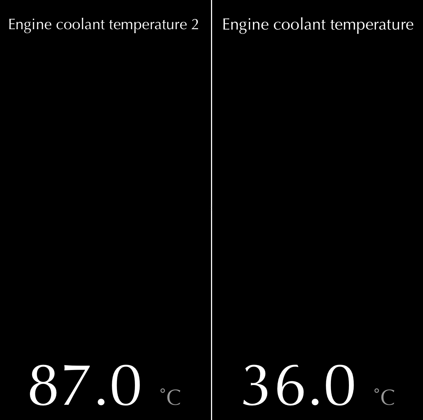

The new temperature sensor arrived from from FCP Euro; I measured the resistance across the two terminals and get about 2730 ohms. The old sensor was registering as an open circuit so I guess that gives me my answer about what's broken. Interestingly I get these temperatures once the engine was turned on:
The new sensor is on the left. Could somebody please record the same temperatures after engine on (cold engine); the 87C seems rather high. It's the PCM module.

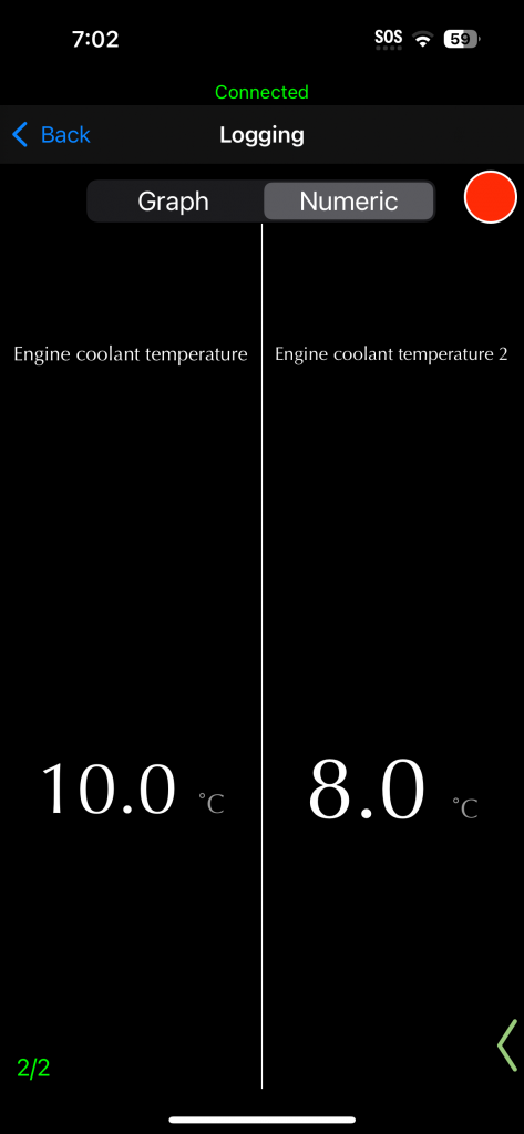

Here's mine with the ignition on but engine off:

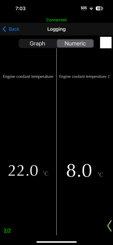

And then after less than a minute of running :
I was surprised at how quick it was going up

Are you sure the new ECT is giving you the reading on the left? That appears to be the hot side coolant temp sensor (coming out of the block), which should be at the back of the engine on the rear crossover. The ECT at the front of the engine (which I think is the one you replaced) is measuring the temperature of the coolant coming out of the radiator (cool side), which would be the lower number on the right. At least that’s my recollection.
In any case, those numbers look high if your engine was dead cold. If it was running even a minute or two, those temps might be correct (mine gets to full temp in about 5 minutes). Or, if you had been running it even a couple of hours before, it might be correct as it will retain heat for quite a while after shutting down.

ftillier - thank you so much, the warming up quickly makes sense I think, the thermostat likely hasn't opened yet... Your values are significantly lower! Ambient when I did the test was 14C. I will need to check again today.
