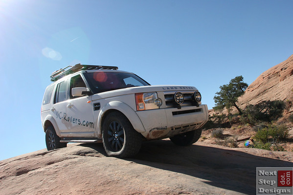

You will be fine with the Nittos on the trails you describe. The Nittos don't rub at slow trail speeds that you will have in Moab, though they will rub a little bit on faster parts, such as the dry river bed in the Klondike Bluffs trail towards Arches NP. You will need to air down the spare to get it to fit under the truck, or just keep it pressurized and stowed in the cargo area like I do when off roading.
If dedicated for Moab, there are better tires than the Nittos. The Goodyears actually did really well there. Street tires have tremendous grip on the sandstone. But for an overall tire, the Nittos are hard to beat as a well rounded tire. (sorry for the pun)
Here are some photos of my LR3 in Moab with Nittos
http://blog.nextstepdesigns.com/?cat=22
