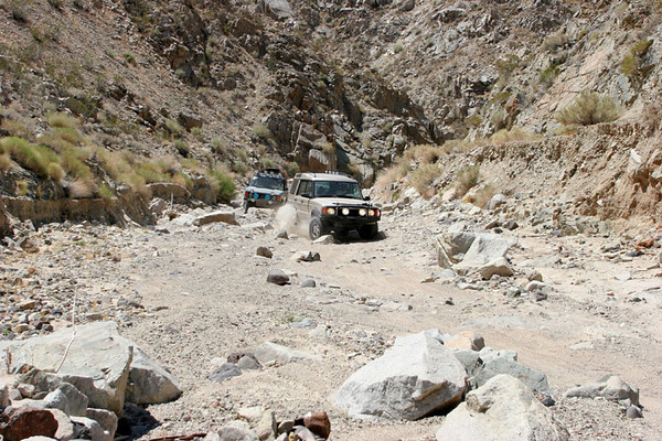

One warning, don't air them down overly much. I was on a fast sandy trail in Joshua Tree, aired down at 18 PSI, and my tires were rubbing on the upper A arms. On the second day out, on a seriously rocky trail, I ran them at about 25 PSI and they were fine, but the rocks did chew them up a bit. I've noticed some chunking out of the treads where the rocks got to them.
Trail Photo:

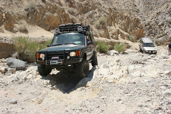

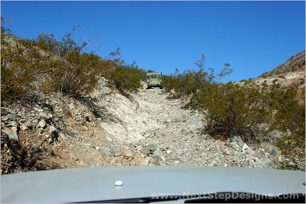

I recently ran through Last Chance Canyon which is also a very rocky trail, though the rocks are a bit more round due to water erosion. I aired down from my normal 40psi to about 32psi and I was real happy at that pressure. The tires wrapped around rocks just fine, handled the sand okay, and provided excellent traction all the way through.
Trail photos:

Sorry for the slow reply. Completely killer off-road pics. I'm jelly. It will be awhile before I'm off-road again (besides the beach).
