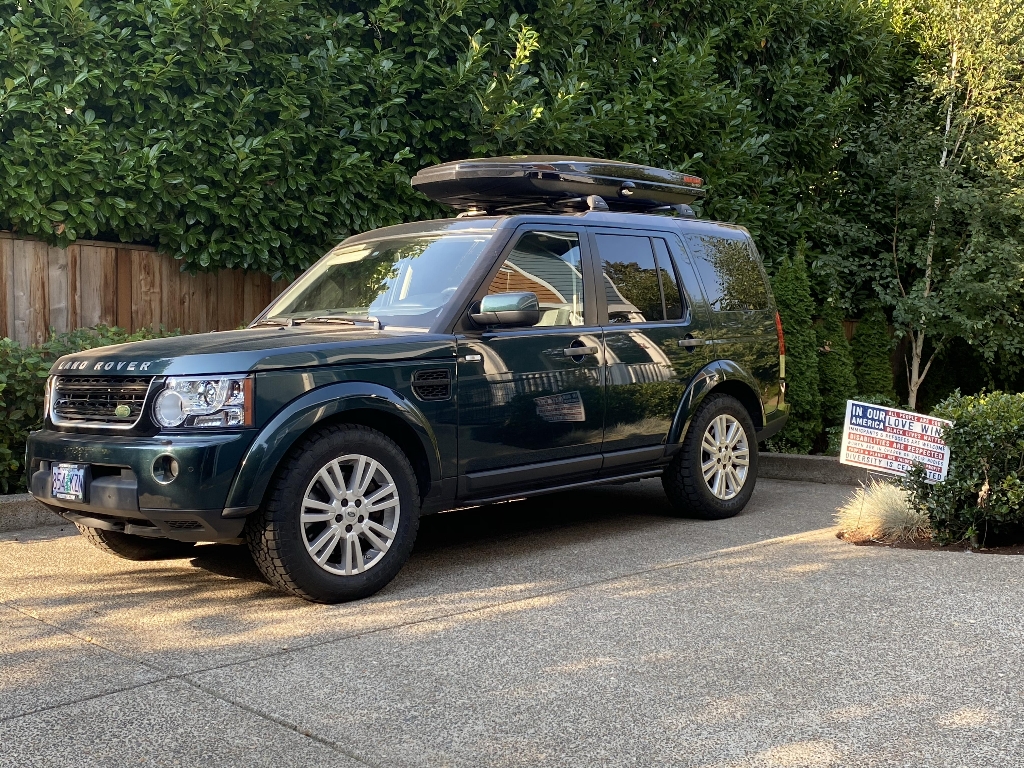

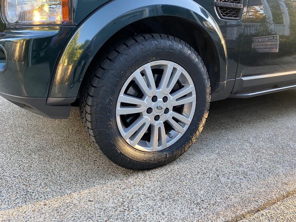

I’ve have the Toyo Open Country ATIII in 255/60/19 for a few weeks and took them over some forest service roads in Washington and Oregon.
They’re pretty fantastic. Quiet on the highway, they track straight as an arrow and feel confident on the mild off-road trails I’ve been on . I don’t rock crawl and have no plans to. Definitely, an upgrade over my Nokia WRG3 SUV. And equally comfortable on road.
