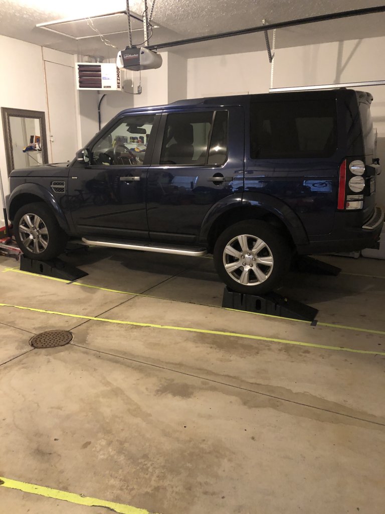

Thanks guys. I for sure will put something underneath. Just for extra clearance I may even drive in onto ramps and then set it to offroad height for added space.
33CHINACARS
Dec 3, 2011
Never, I repeat Never get under a car unless it is properly supported . If you have nothing else even use the spare tyre. It only has to come down once to crush you. Leaving the door open should stop it from auto leveling.
