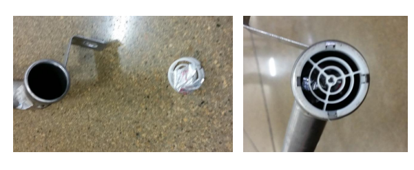

Is this "spitback flap" present on the V8 tanks also? If so, would it prevent a hose from passing through? I don't have a borescope that is 5' long.
Alternately - is there an anti-siphon feature at the filler pipe/tank junction, as seen in this NHTSA TSB for Range Rovers?
I'd rather not try to remove the filler pipe and take a bath in 10 gallons of gas (until the level is below the filler inlet).
Google, YouTube, and forums have not been any help so far.
Range Rover anti-siphon grille:
Rover Range
Jun 13, 2022
833
492
Texas
You can remover the filler pipe hose at the fuel tank. Maybe loose about a teaspoon of fuel.
The one way valve in the tank can be pushed open with a screwdriver. Fuel will come out then.
