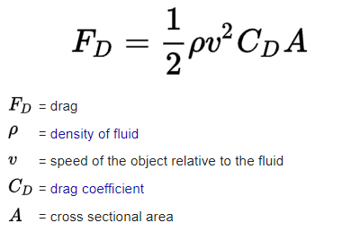

LOL yes velocity contribution to drag is squared.
