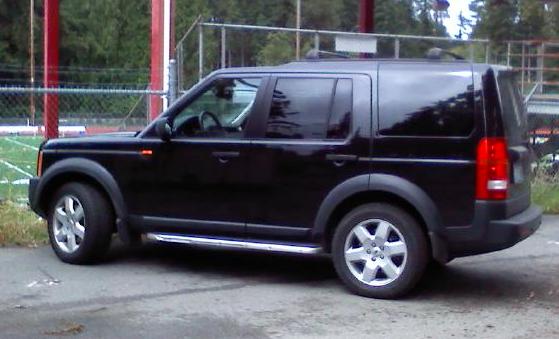

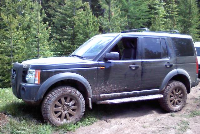

Yeah, that would be a good idea. I have no intention of running them 24/7. Those 32" MT/Rs are kinda big for the LR3 and the Rod-Mod makes it work. However, the on-road handling is noticably worse than the stock config. I've made the investment in separate rims, tires and rods and it only takes an hour to convert so I'm happy getting the best of both worlds.
Here is a before/after view:

Hey, cool...when did ya get the 'correct' rims for the MTRs?

I got 'em about 3 weeks ago....good of you to notice! :biggrin:
they actually make a difference funtionally too. The other rims worked but were not the correct offset and caused rubbing up front when I turned. These are awesome....no rubbing at all.

REALLY doesnt even look like the same truck! Looks great. Makes me wish I had done 2 sets. My General AT2s look like they will eat small children in the grocery store parking lot, but also look like slicks at Rausch Creek.

Thanks Morris....I'm really happy with the direction I went (getting two sets) and the performance of my set-up. I only put about 1500-2000 miles per year on the MT/Rs and at that rate they will last forever. Also, I can ignore concern over CV joints and such for the same reason.
The LR3 not only looks like a different rig, it perfoms like a different rig too! It's sleek and smooth on the road and it's a beast off of it. I've even become an advocate for the indi suspension (with the cross-linking)...I have no diffs hanging down to worry about. 12.5" down the center and the skid plates from engine to T-case so not much to worry about. My only weak spot are those running boards. The pics reveal that they've taken their share of abuse. I will eventually replace them with sliders.
