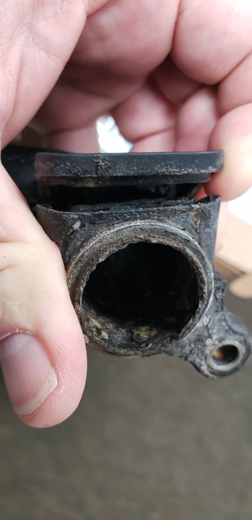

Change the front and REAR crossovers. Just do it. Before you even drive again. I had just had water pump replaced and cooling system serviced, dealer said all was fine, at 103000 miles. ...
$21036.47 and new engine...runs great. Total engine failure at 65mph, in LESS THAN 1 MINUTE. Not worth it.
Every one, if you still have these then change asap. Just not worth the risk, especially when it is a known problem. Not a bad DIY job, but even dealer price is pennies compared to engine change. Back is harder and time consuming because of need to remove supercharger. And having done that, SC coupler or snorkel rebuild is a good idea as are timing chain or at least guides. Water pump as well. Otherwise, it's all pretty durable with good maintenance.

[mention]Robin Parsons [/mention] is right. The crappy coolant crossover pipes are some of the engine's biggest liabilities - if they haven't been done by 75K I think they should be done pre-emptively. The likelihood of failure is too high and the cost of failure is also too high....as Robin knows. I did mine literally the week I bought my truck at 72K miles.
