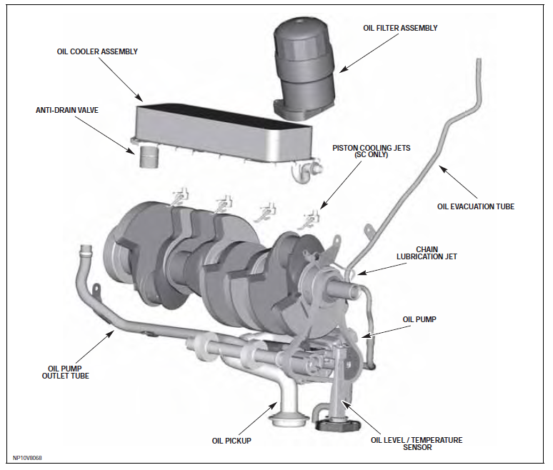

You could put an elbow on the oil level sensor housing, attach a long tube. Run the tube to the top side. Insert your dip stick in the tube.

It is really unacceptable if you ask me. Based on the diagram above, there is a low oil sensor. Based on this experience that is a non-functional part.... and actually even worse than not having it at all. It provides some sense of security that the engine has a check on this sort of thing, but in my case it was over 50% down and no light. I don't know the critically low level, but had I had ANY indication of a problem I may have saved my engine.

I will add that the electronic gauge is totally useless for another reason. It goes from the very bottom gauge (empty) to full over about 1 quart of oil but only at the very top of the volume. Its not linear. In other words, at 7.5 quarts it will indicate low, and at 8.5 quarts it will indicate full. A major pain to fill the oil if you don't start form empty because you have to go through this whole process on the gauges over and over while you add oil to not over fill. Empty, Empty, Empty, Empty, FULL. Also, if it is on the low side, one would think that an indicator light would pop on, but it doesnt. Check your gauges folks.
good point - how low does the oil need to be to trigger the low level threshold?
