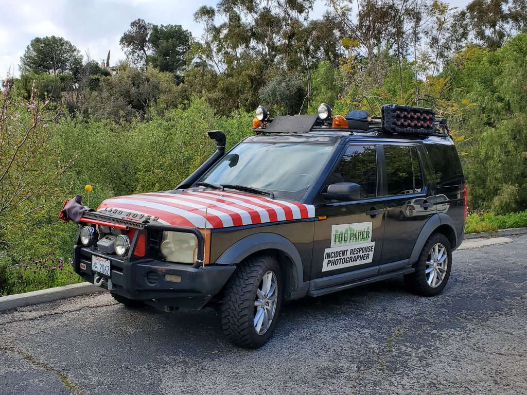

My LR3 has 230,000 miles on it and the engine went at 150,000 because the damned coolant recovery bottle sprung a leak and because the temperature sensor is located on the bottom of it, did not register the heat rise (REALLY STUPID DESIGN.) During our riots here, I drove it to LA hoping that someone would firebomb it. LOL It may be a peice of crap, but it's MY piece of crap.
