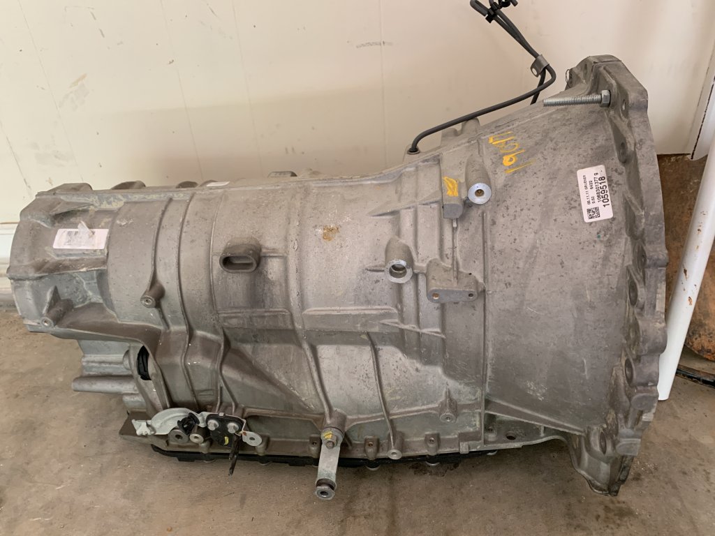

It’s here! Shorter than I thought (17” tall from bottom of pan to top of bell housing). This will slide under, no problem. Teardown starts tomorrow am.
Still going to go in from underneath. Will document progress and learnings as I go!

I don't know anything about this specific trans, but in general, it's a good idea to replace any external seals/O-rings while the trans is out of the vehicle. I'd at least do the converter shaft seal, and any other seals behind the converter area.
Looking forward to following your adventures!

Sweet. Looking forward to your reports. Hell, can you set up a GoPro?
Take a ********* sharpie and write "Schmerge Was Here" on top of that bad boy for anyone who pulls it out in posterity!
And I would definitely change those seals and the connector sleeve while it is out. If they leak in the future, you would be smashing your head into a wall.

Haha. Done!
I’ve been debating the seals and connector sleeve. It’s brand new in my old transmission and it will be no thing. I’m already swapping the metal pan and filter

False start. Got it up on stands and realized I need female Torx sockets for driveline (prop shaft and drive shaft).
Access looks somewhat tight from transfer case to transmission. Much more room around bell housing once exhaust removed. May try to take it out in one piece...transfer case and transmission
