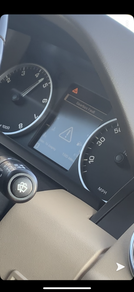

Have to resurrect this thread. Got a gearbox fault today when accelerating on the freeway. From gears 3-4. Normally throws a transmission fault but this time it threw a gearbox fault instead. Only happens when the car is hot and been driven for a while. I had a thread prior to this one about this and they said it was bridge seals and valve seals. This would make sense but I spoke to a zf transmission expert and they said the seals don’t feed fluid to the 3-4 solenoid and or the e-clutch. Did anyone ever experience this or solve it? Don’t want to have to give up the car after the massive amounts of money I just spent making it perfect.

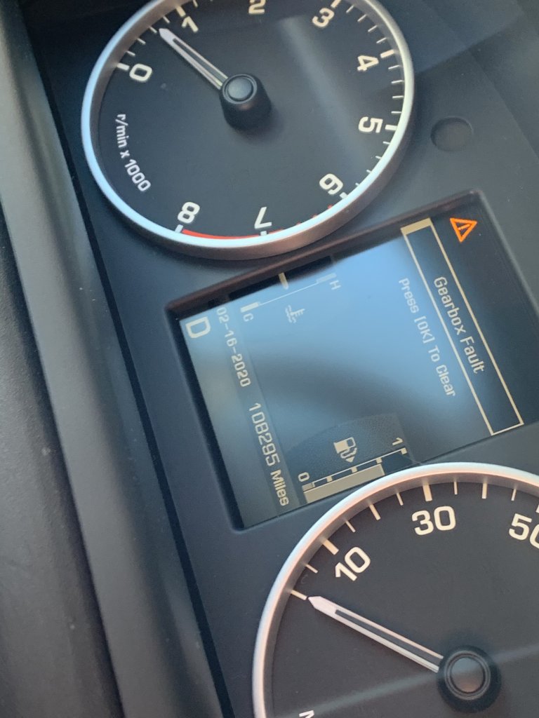

So a couple day ago, my 2010 LR4 with approximately 90K miles decided to scare me. While driving on the toll road (with the wife, two kids, and a mother-in-law) at about 75 mph, the transmission seems to “pop” out of gear. The car quickly decelerated, while the engine revved up to near max rpm and the accelerator was irresponsive. Somehow, cars behind were able to swerve around me and I was able to coast across four lanes of traffic and onto the emergency shoulder without being hit. There was a “Transmission Fault” message and the service engine light was lit. After taking a few minutes to recompose myself and restarting the car, all error messages went away and the car drove fine all the way home.
Was able to pull codes P2704 and P0783.
After some searching, found a TSB LTB00514NAS1 that mentioned those codes but not a whole lot of details. Has anyone dealt with this?
I've read things from low fluid, to solenoid, to stator bushing to harness and sleeves and even the infamous brake switch can cause this.
I did the filter and oil change about 4k miles ago and have check the fluid level a couple times.
I hate dealership service department, but I got an appointment this Friday to see what they say. I'm expecting to hear "You need a new transmission".
Get a second opinion from an Indy...also check your fluid level again and check all the wiring around the tranny.
