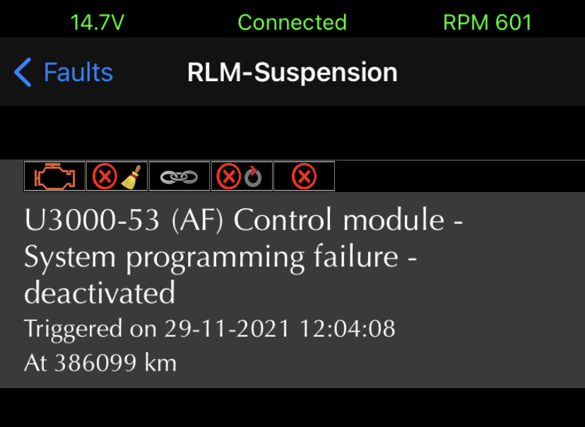

I took your advice and that if others here on the forum and finally bought an IID scanner. This is the code I pulled. I also ordered a replacement Hitachi style compressor - and tried to pull the bolts for the casing and 2 tori crews snapped and the 3rd stripped. chances are it is the compressor but any suggestions on how to get stubborn frozen bolts? this is northern New England... anyone out there good at confirming this code?

thanks - that was helpful but so far I can't find much of anything regarding this code and the GAP Toolis pretty vague regarding the issue. Feel like I could have better spent $450 and received as much information from a store bought product. unfortunately I can't find a mechanic in Norther VT that wants to touch a 2010 Land Rover. everyone is slammed and selective about what they have staff to work on.

It might be worth a quick email to Patrick / GAP support ([email protected]) to see if he has any ideas for you. If you email him, include the full text of the fault along with the ECUs list which you can export from the app.
My 2012 manual says this for U3000-53: "This is not a fault. ECU temporarily deactivated following programming session. Please cycle the ignition to clear." Obviously it's not clearing when you cycle ignition, but it's a strange failure. Might be worth trying a vehicle reset by disconnecting both battery cables and letting it sit for a while?
