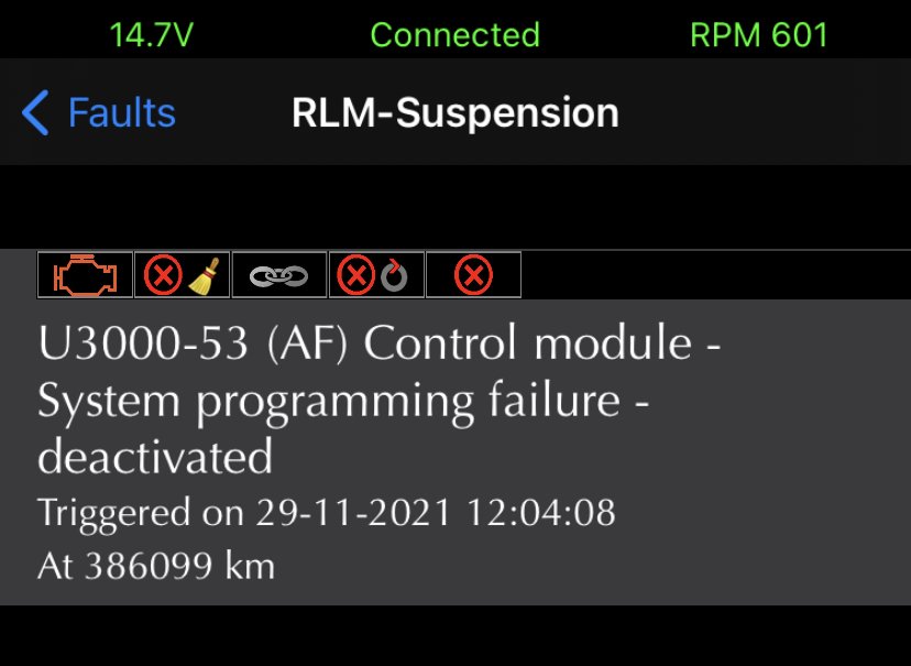

The code I got was the code I got is U300-53. I searched around for this and came up with virtually nothing. any insight would be great!

Search google.
But, like has been said at least twice in this thread, it's probably your compressor. If not that, it's probably an issue with the wiring leading to the compressor.

yes - and the suggestion to reach out support from GAP was helpful - he came back with some recommendations but to do them before touching the compressor. the code from that tool are pretty cryptic. (at least in this case)

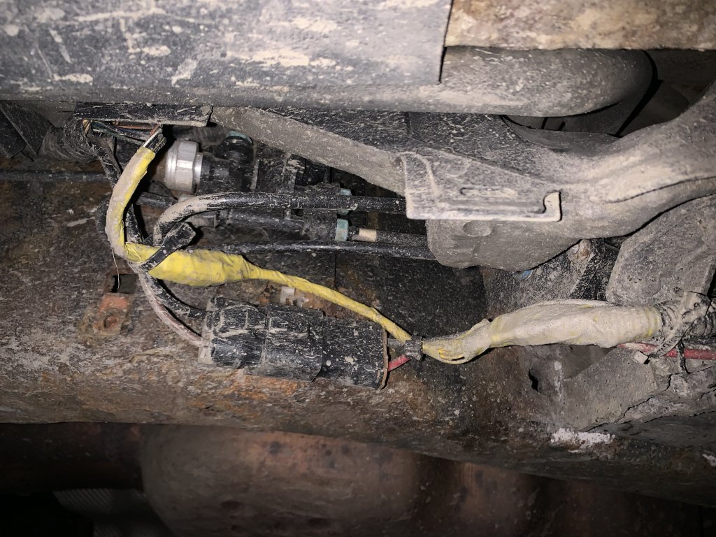

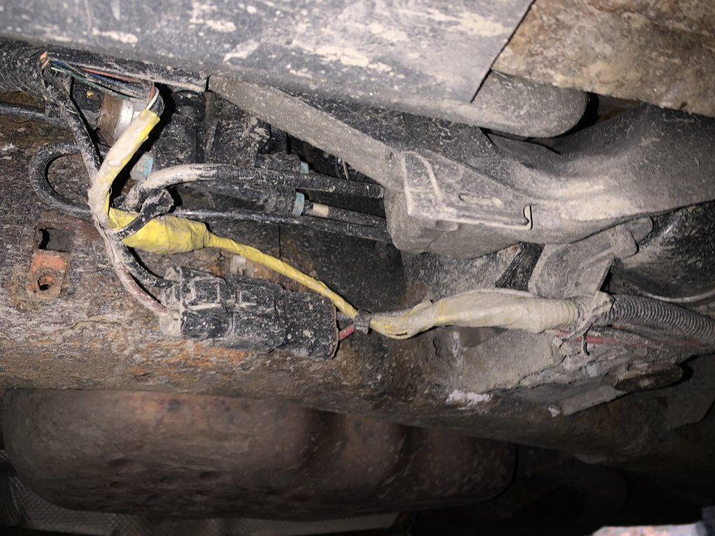

@ryanjl was actually spot on and Patrick from the GAP team was super supportive. the GAP Tool actually allows you to directly upload the error to them and he diagnosed the following:
Hello
C1A36-01 Exhaust Valve - General electrical failure
NOTE:
Circuit reference EXH_V_POS / EXH_V_NEG
Pilot exhaust valve circuit short circuit to ground, open circuit, high resistance
Refer to the electrical circuit diagrams and check the pilot exhaust valve circuit for short circuit to ground, open circuit, high resistance
Wiring attached,
I went ahead and purchased a new compressor and went to install it and when I pulled the wiring harness off all of the wires disconnected and THAT was the culprit! I returned the compressors and rewired it (bypassing the wiring harness). all is well and operational. Merry Christmas and thank you Patrick at GAP!
