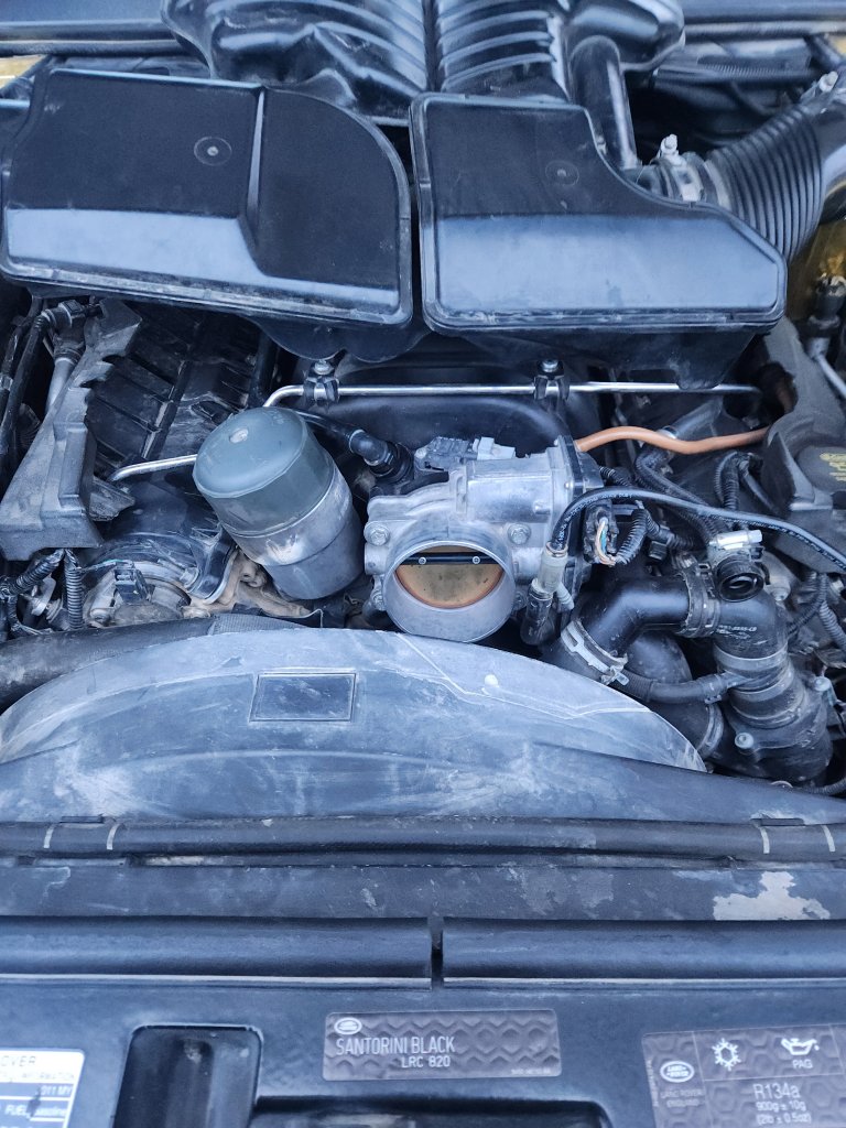

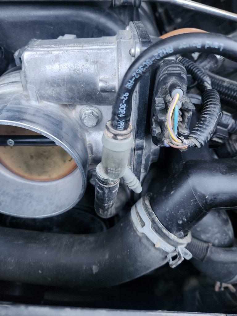

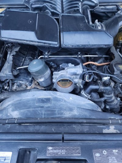

The best way that I found was to open the expansion tank and remove the intake harmonic tubes to access/disconnect the gray coolant connector near the throttle body to fill coolant. That line runs between the lower rear block to the expansion tank overflow and filling it guarantees coolant is in the block. You might still have little air pockets, but filling the block will help circulate coolant to remove air pockets from the block. Keep some coolant on hand to top it off after a drive.
Getting access to the gray connector, removing the intake harmonic tubes.
The gray tube with the retaining clip removed, just disconnect the tube and use a syringe to fill it up with coolant.
