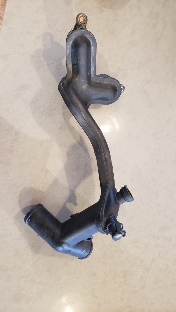

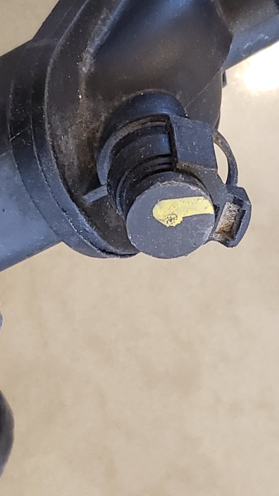

For a 5.0L V8 the bleed valve is shown below
Mozambique
Feb 26, 2018
287
31
toronto
I would let the shop sort it out at this point. Just make sure tactfully that they are aware of the correct bleed procedure. The DIY at home procedure involves raising the expansion tank a couple of inches. Google it to find the procedure. Make sure they replaced the bleed valve with a new one. The replacement crossover does not come with a new one. They go brittle and can fail too.
