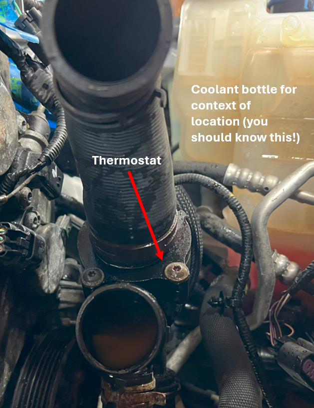

Water pump:
https://www.fcpeuro.com/products/land-rover-water-pump-kit-genuine-rover
Also agree that you should only use OE (original Land Rover) for these parts.

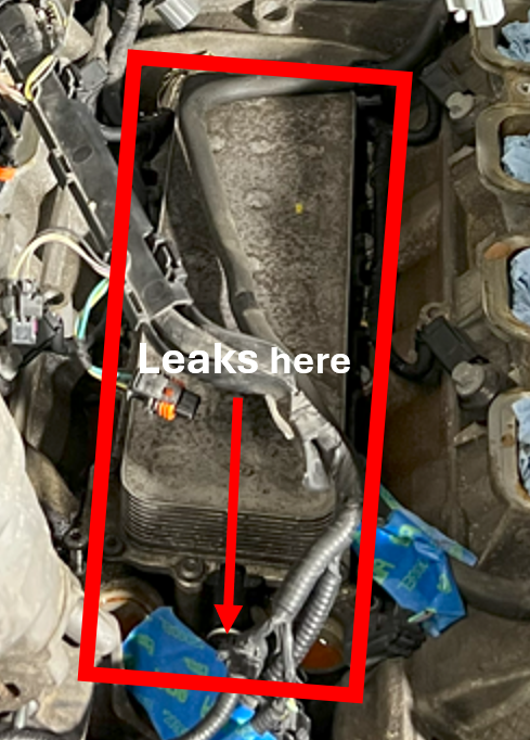

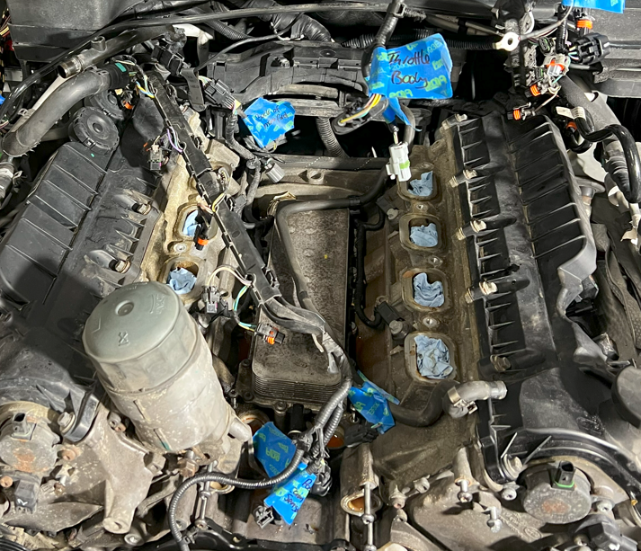

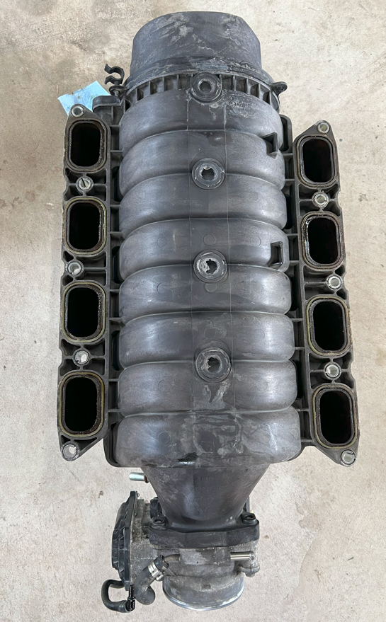

Here's the oil cooler assembly, it sits in the "V" of the engine and is typically covered by the intake manifold which in turn is covered partially by the intake plenum which in turn is covered by the engine cover; given mine is in parts at the moment I can show you these photos... Starting zoomed out here's the engine:

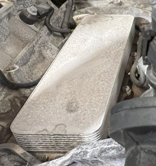

This is the oil cooler assembly (and a pointer to where this connects to the water pump and a typical leak point - which mine was also doing):
Here's the intake manifold (sorry this is the underside but hopefully gives you the right idea):
Zoomed in here is one of the eight inlet manifold gaskets (their just rectangular rubber "rings" that pull out) these seal the inlet manifold to the engine block so that air cannot creep in to the engine which would then cause other faults:

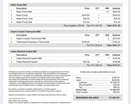

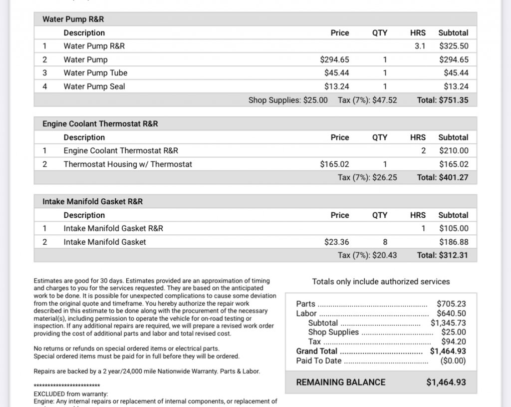

This is the repair cost and it is a LR mechanic. That’s coming to my house ! Yay!!! I think it’s pretty good as far as costs. All OEM PARTS, I also got the oil cooler from FCPeuro and was much less then through LR. OEM also.
