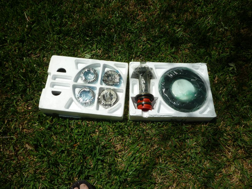

I got my rear locker diff rebuild kit today. I think i'm going to consider the royal purple as well when complete.
In any event, re-engineered to prevent the "whine" people complain about, and should be better than factory new when complete. I am very excited.

Keep us updated on how the install goes. Could you also link the store you purchased your ring & pinion kit from?
