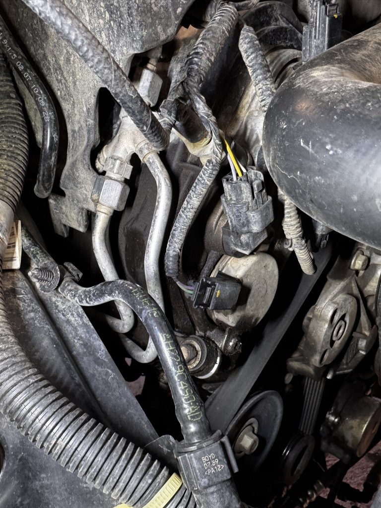

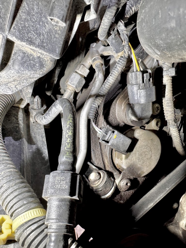

Hello all. After pulling my skid plates to start in on fluid changes for my difs and transfer case I noticed some oil leaks I hadn't seen before. It's not leaking enough to leave any on the garage floor, or on the underside of the skid plates, but there is definitely oil strewn about. Looks like one is the Vacuum pump which seems straight forward enough to deal with, I'll start with replacing all the gaskets on that one. From best I can tell, it looks like I have a leak coming from the frontside of my passenger side valve cover gasket and/or my front timing cover. I've attached some photos below to show what I'm seeing. I checked all the other threads on these issues which were very helpful in getting me pointed in the right direction. But had a few questions I wanted to clarify before diving in...
1) Based on the pictures is there any way to tell if the leak is coming from the valve cover gasket or the front timing cover? It's just a mess in that area...is there anyway to more clearly diagnose? I suppose I could clean the entire area off, then monitor after driving to see if I could se more clearly where the leak is originating? Also, fyi the drivers side valve cover gasket and timing cover are both bone dry.

1- I think it’s the VCG; front passenger side seems to be where most leaks start on these for some reason. I could be wrong but I think the timing cover leaks a little lower than the top usually; mine did at least.

If you're going as far as replacing the VCG's, you may as well reseal the timing cover while you're in there. If it's the pax timing cover it will destroy your alternator. Ask me how I know :).
Also be aware that the valve covers can warp over time and the gaskets alone will not fix the leak. If you're at 140K with the original valve covers; you may want to budget for new covers too. It would be a shame to have to redo the job. This coming from a guy with a 2011 who replaced both valve cover gaskets at around 90K (Dealer did the work under an extended warranty at the time) only to go back in and redo it with the new valve covers a few K later.
