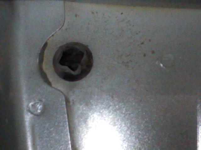

Thanks a lot guys! I sure appreciate this message board and all the info on it. I hadn't even noticed the piece of foam behind the rubber boot! So I found the drain behind it. I THINK it's already been clipped. It was dark and I couldn't get a great look at it but the end cap looks and feels as though someone has clipped it. Here is a pic:
Does it look clipped?

Cool....I wonder who the heck did THAT!?!?
I hope the Phantom Snipper also did the other drains!
