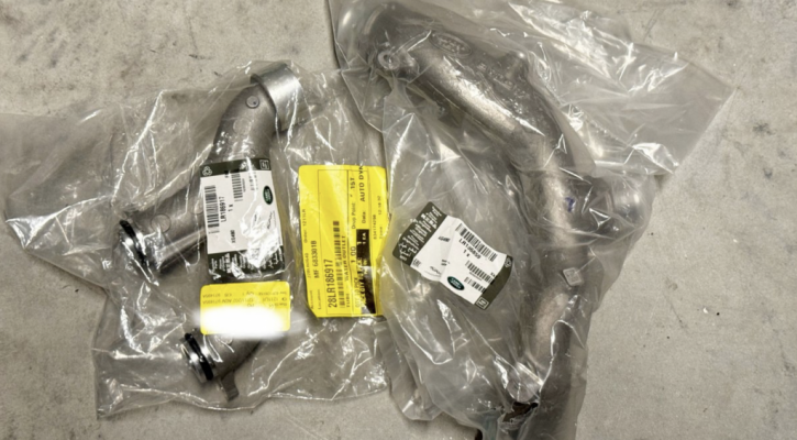

There aren't many symptoms. They catastrophically fail on these vehicles and usually take the engine with them when they go...
I would recommend having it replaced. There is an updated part.
As for how much it costs, mine was done under warranty so I'm not 100% sure but I believe it should run you anywhere from $1000-1500 on the V8.
