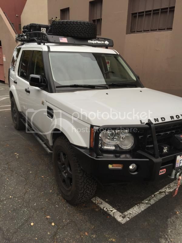

265/65r18 I think that's the limit unless you want to get stuck if you get a suspension fault. I think this is king of the hill

Nice! I had read some people are running 275/65 and then of course 285/60. Assuming the 275s would require some work though. I would maybe go with the 285s, wider stance sounds good to me.

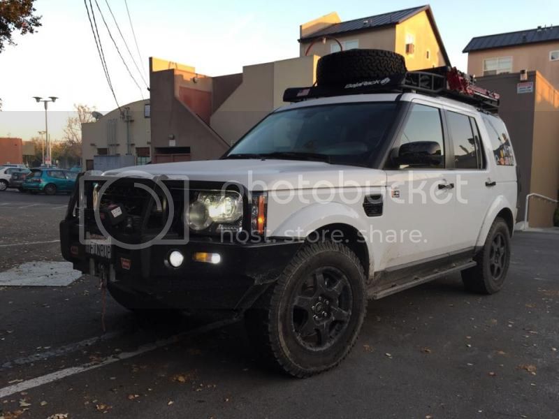

Even with 1.25 you do need to grind the calipers as I did and if you want no rubbing on the frame Horne you also need to cut and weld that too. I'm happy with my mods

Yes you still need to grind the huge front calipers for them to work or get a larger spacer. Probably just a few more millimeters.
Compos are the easiest and priciest solution.
