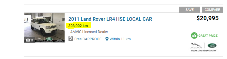

LR4s can apparently get to at least 300k kms. This one has: 308k kms (192k miles)
