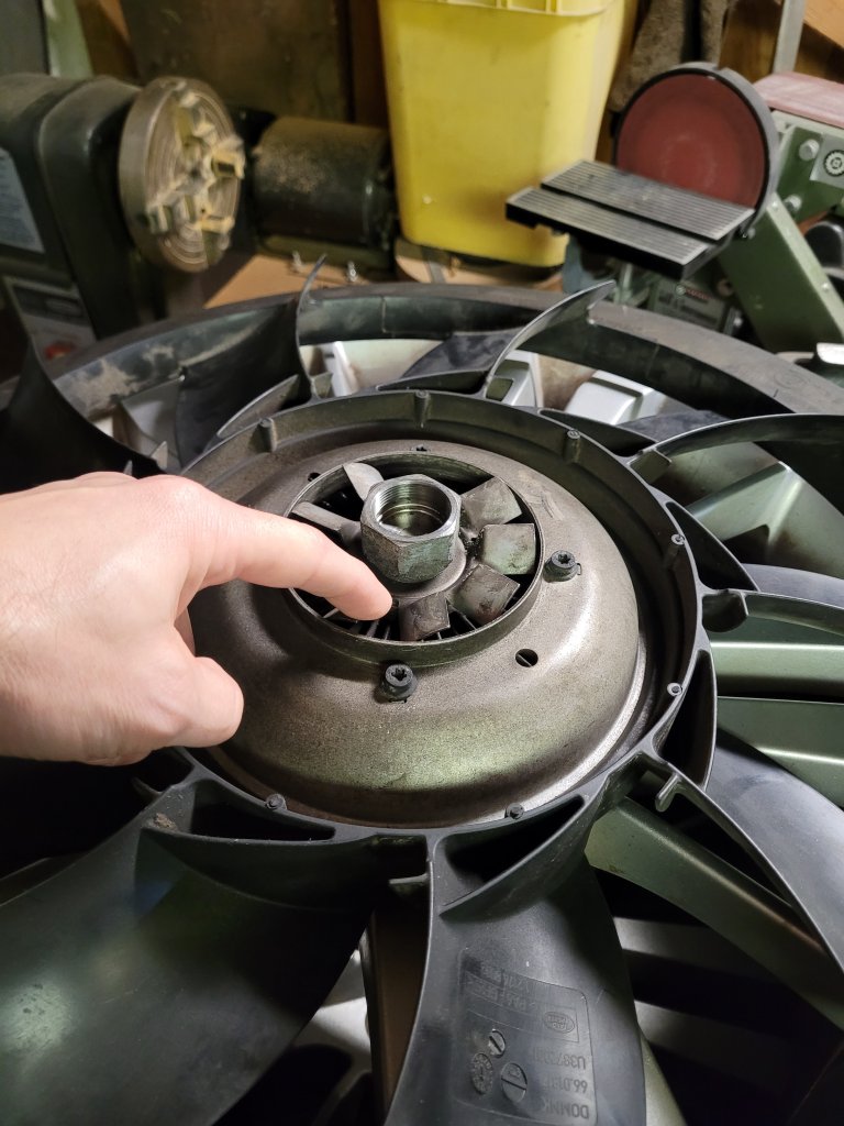

Look at this little guy. I have two 5.0 engines and both make a very similar sound. I believe when it sticks then pops free it makes the click. Yes, mine has a fin broken off. Doesn't seem to affect anything. It should spin freely. It's on the back of the fan assembly.

With mine, once it warmed up the ticking noise went away. It was like that for over 18 months and I never bothered to do anything about it because it didn't seem to negatively impact performance. The noise got a lot louder recently and I was concerned about the fan potentially freezing up and leading to an overheating issue. I bit the bullet and got it replaced. Maybe unnecessary, but it gave me peace of mind.

Mine ticked since brand new back in 2011. 125k miles later and still ticks on a cold start/cold weather. I had read something saying during initial engine start up, the electronic fan clutch may produce a loud fan roar or an audible click for up to 3 minutes - this is normal. The noise will cease shortly after disengagement….not sure why some fans remain silent on some LR4’s and why some get silent after a replacement.
