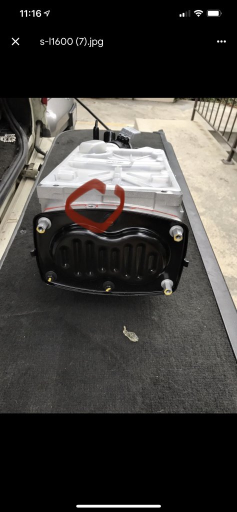

Here you go. It’s easier to do when off the car but manageable when mounted. The plug is at the back next to the firewall where the casting drops by an inch or so from the intercooler flange. Sounds complex but you’ll see.

Something like this

FWIW, I'm pretty sure mine had the plug facing the back (firewall) not on top.

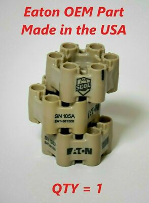

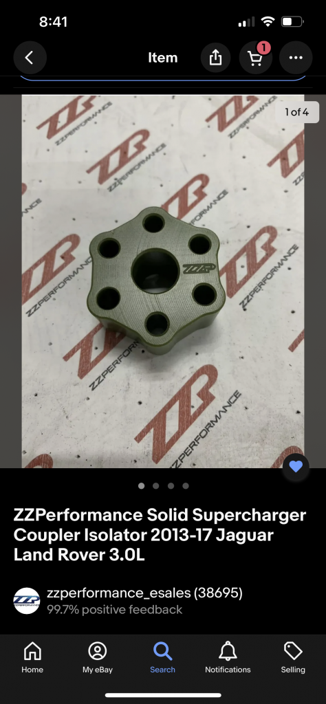

Also for the coupler - superchargers online seems to only have 5.0 couplers, and eBay seems to have a lot of knockoff looking ones. I did see this one that seems like an update to the upgrade

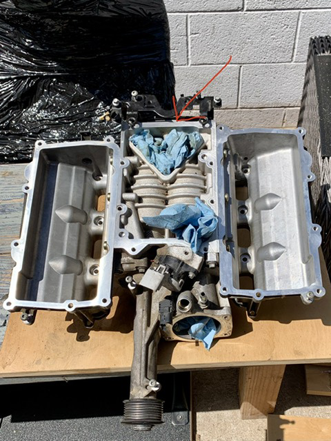

This is what I used a while back.
Here it is without the oil.

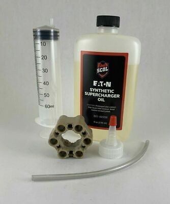

If you email this seller, he might know the oil refill amount. I didn’t change the oil because it looked perfectly good when I changed the coupler. You could just siphon out with a syringe and put back same amount. Its not much oil to my understanding.
