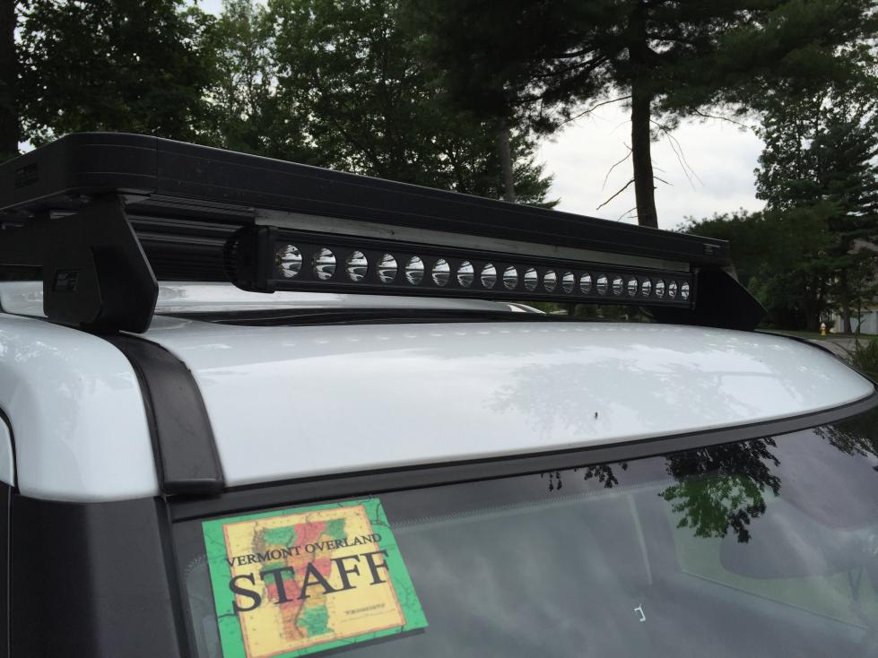

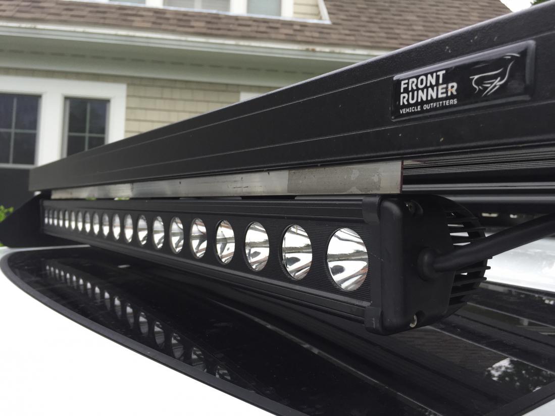

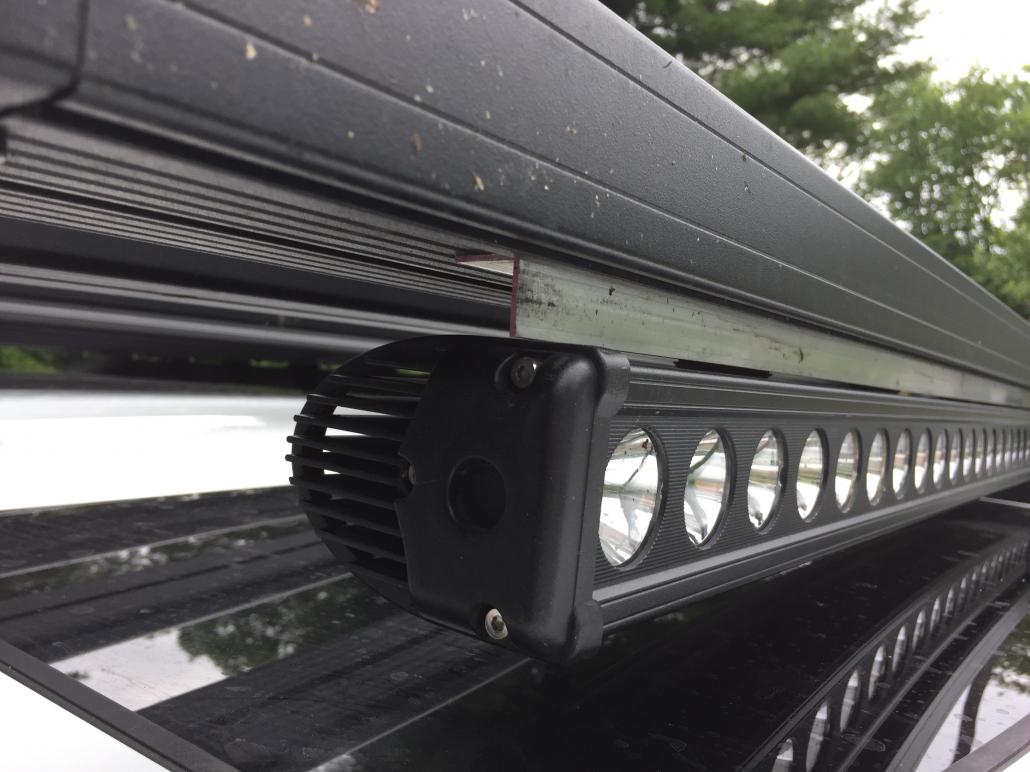

Excellent now that I did away with the gap between the light and rack. When I first installed the light, it left a 3/4" gap that caused the most ungodly whistling that was deafening. I cut down a piece of L aluminum stock to mount in between and that has made it extremely quiet.
Nas, can you post a close up picture of the modification you did on your mount for you light bar. I just had one installed and i have the same ungodly whistling noise you had before.

Here you go. Note I haven't painted it yet as trying to decide if I will go black or keep it silver or white as it blends in. You can buy some stock from Lowes or HD, etc.

That looks pretty freaking cool NAS. I've always wondered where and how you route the wires for lights like that. Is it a permanent mount, or temporary?

Thanks again, I routed them up the pillar, under the last and then under the trim piece on the roof. For me it is removable.

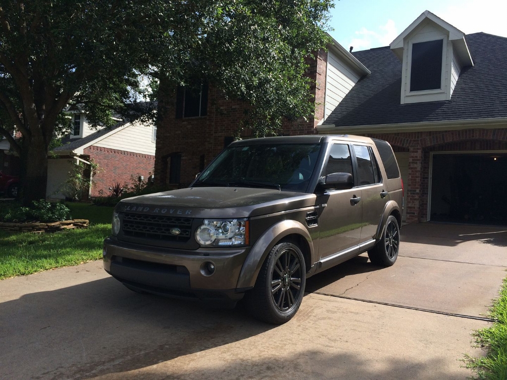

New boy here.
LR4 Nara Bronze, freshly plastidipped! (wheels, grill and vents)
..may have to go permanant
