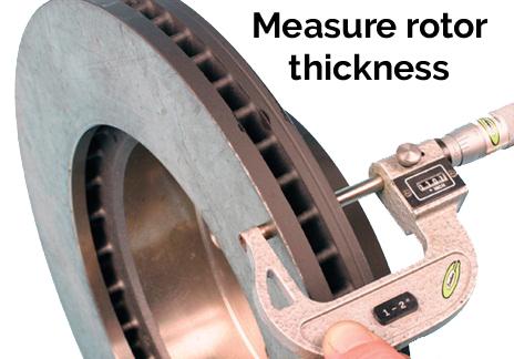

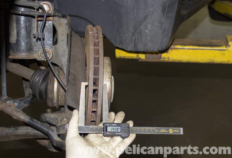

I keep reading about a "lip" on the rotors. This lip is NORMAL if the rotors are not brand new. It doesn't automatically mean the rotors are worn out. A very pronounced lip may indicate the rotor thickness is below spec, but you have to measure to find out.
There is a factory thickness specification for a reason. Use a micrometer or vernier caliper to measure the exact thickness of the rotor to determine if it requires replacement. This assumes there are no issues with vibration or pulsation which may indicate deposits on the rotor friction surface, or a warped rotor. For the 2010 LR4, front min thickness is 27mm; rear min thickness is 17mm.
Back to the OP who stated: "One of my shops said that any amount of lip will almost definitely cause squeaking if I only replace the pads... [and] I would hear the new pads for as long as I had them." <-- Bullcrap. If the rotors are in spec and there are no existing issues besides worn pads, just replace the pads. I did exactly that on the front of my LR4 a year ago (OEM Ferodo pads) and there has not been the slightest hint of squeaking or noise; and my rotors are ~50% worn.
Random photos from Google (non-LR):
