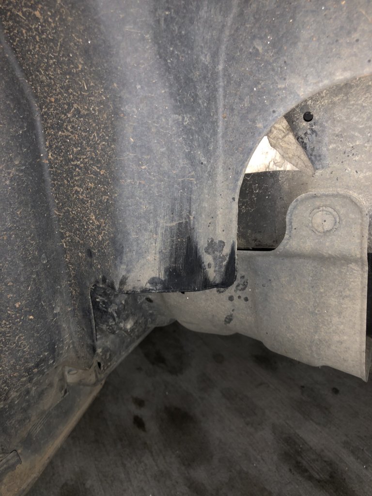

I took a super quick peek underneath the vehicle today and was able to identify what’s rubbing. The tire is rubbing on the driver side inner plastic fender liner. The rubbing only occurs at full lock to the right. It does not happen with the equivalent fender liner on the passenger side when at full lock to the left, which is interesting.
I need to compare both sides to see what is different when I have a chance. I wonder if something is just out of place on the drivers side liner? Hopefully I can just adjust something. Overall I’m not too worried since it’s not too rigid and has room to move.

It's rubbing here (see pic), but on the driver's side. The liner was not flush against the frame, but out a few inches. Again, not sure if it's the same on the other side or not. Didn't have a chance to look. I'll post findings once I have a chance to get under there and look at everything. It does seem odd that one side would rub on the liner and not the other.

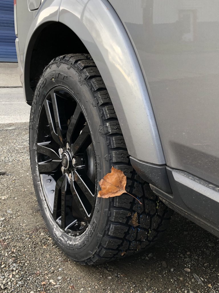

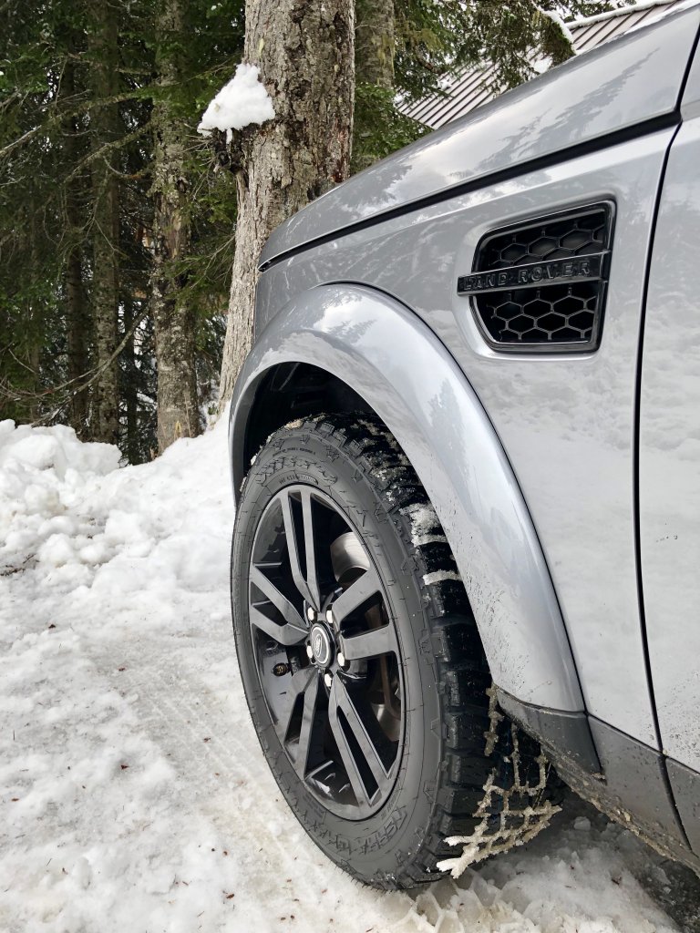

Aside from the rubbing issue, the switch to 20’s, 265 G2’s and black design pack pieces does make the vehicle look sooo much better.
Looks great!
How do you like the Nitto's? I see snow in one of your pics - how are they in the white stuff?
My guess on the rubbing is the inner liner is missing a clip or a clip is undone.
Yeah, hoping it’s just something like that. Worst case, if I remember correctly, could just trim the liner at the contact point.
There wasn’t much snow on the roads, so didn’t really get a chance to test those conditions. I just played around in some deeper stuff off-road, so for the most part it just felt like muddy conditions. I did read they do really well on road in snow. Hopefully I’ll get to test that out in a couple weeks.

i wouldn't trim the liner before trying to zip tie it back just enough instead.
There's no real surprise as to the rub only on driver side there. The liners and whats behind them are different. That spot is tight on mine too and I di actually cut out an arched shape starting at the corner about 3" wide and going up about 4-5" but it was to clear much larger tires.
You can also try using a heat gun to thoroughly warm the zone, then bend it back inward. Most likely that tire only needs a 1/2" or so expansion of space to clear.
Looks good. That offset is nice when it works.
Now that I think about the turning arch, are you sure it's right in the nook of the liner and not more like a few inches outboard? Having the stock bumper it may also be that the way those parts all connect, you'll have to do some adjusting of how the liner is held in place where it comes to the bottom edge.

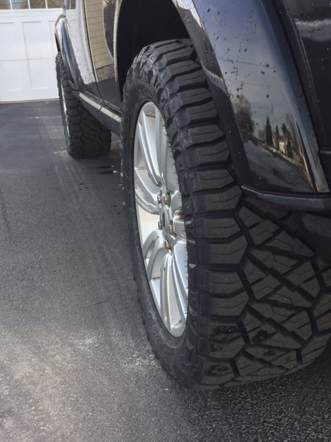

I just put a set of L322 RR 20’s on my 16’ LR4 with 285/50 ridge grapplers. They fit fine, but I needed a .75” spacer to clear the upper control arm.

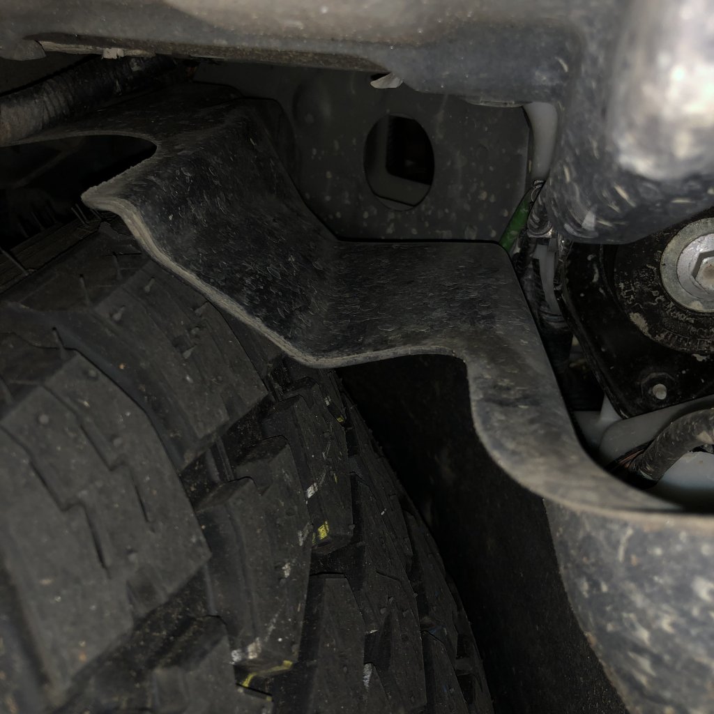

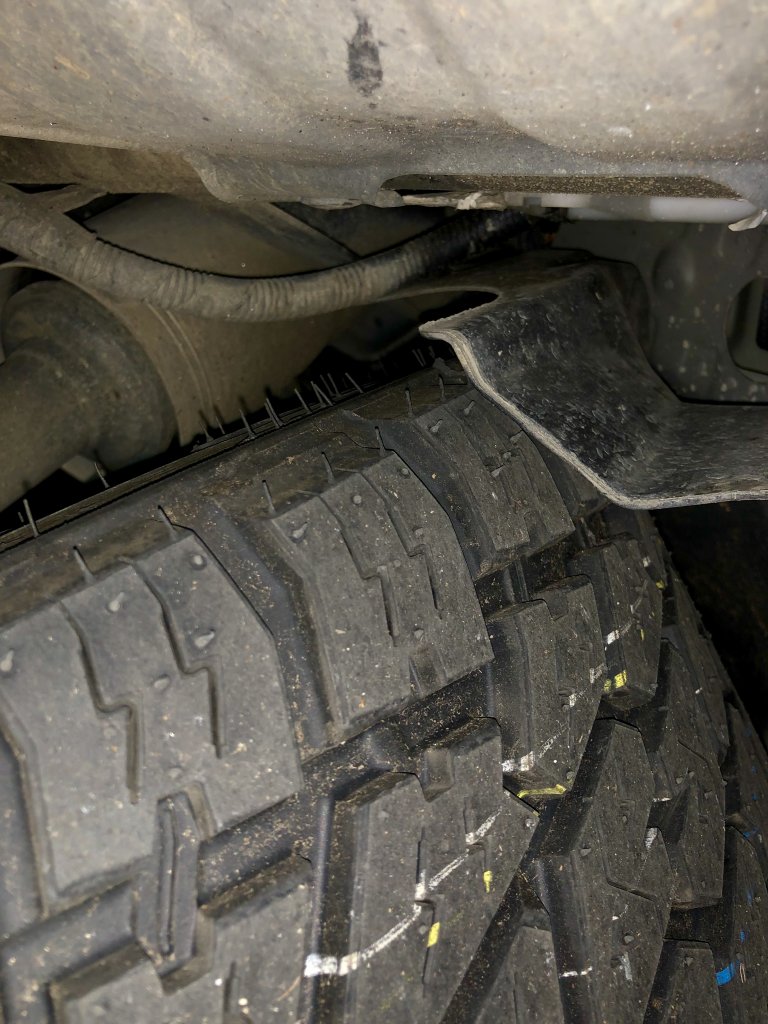

Some pics of the rubbing contact points on the drivers side at full lock to the right. Seems like clearance must have been super tight even with stock tires sizes, so I’m wondering if something is off.
And plenty of clearance on the passenger side.
