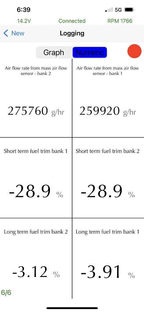

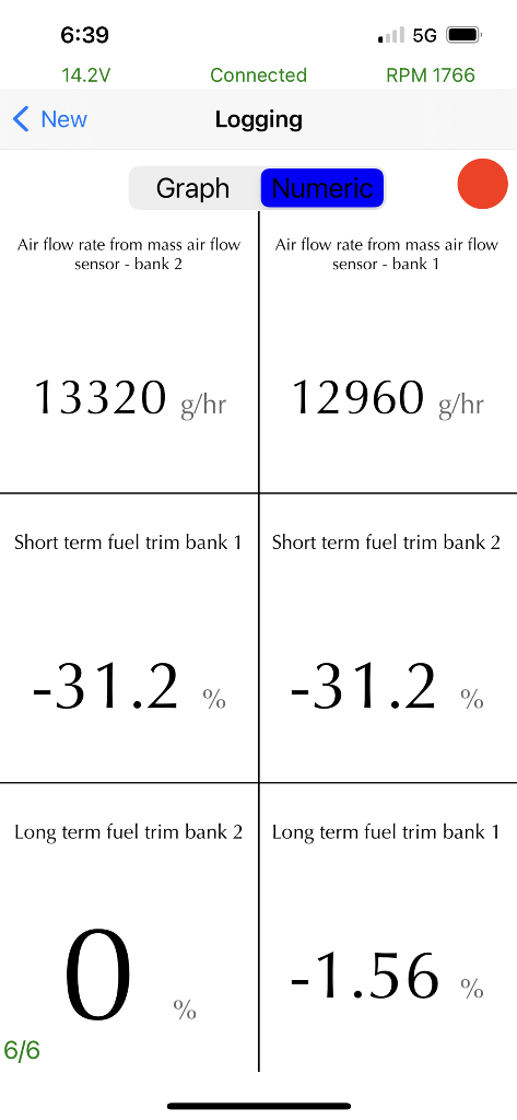

Ok, fueled up again this morning, truck stalled out about 1/8 mile later at a red light. Idle was rough, a normal person probably wouldn't notice but I could tell. No codes other than the P0442 small evap leak.
more live values:
idle
3/4-ish throttle, pulling 3k rpm ~50-55
1700rpm or so, cruising after the pull
any ideas from the resident pros? I haven't had the time to replace those PCVs yet, I'm doing that tomorrow evening and have some time to do more troubleshooting if there are some other values I should post up.

That’s super rich. Since it’s tied to refueling, I’m guessing you are getting fuel into the evap canister on fill ups, and when that purge valve opens, the mixture is getting too rich. If you get enough fuel in the canister, it can actually pull liquid fuel right up through the purge.
Topping off the tank can create this problem, but I also seem to remember some problem with the filler neck (but I never heard what exactly the problem was) that was causing fuel to get into the evap line.
I don’t top off, first click and I’m done. I had to do the TSB on my Silverado regarding the vent valve so I’m privy to that stuff. I’m thinking I may have saturated the canister last year when I was having issues filling the truck? I was hoping this would all go away after the fuel flange recall is done since most of this stuff has to get disconnected do that… lol..
