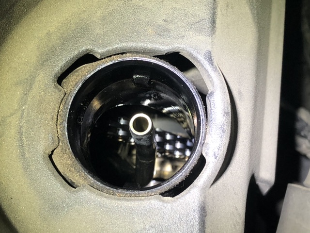

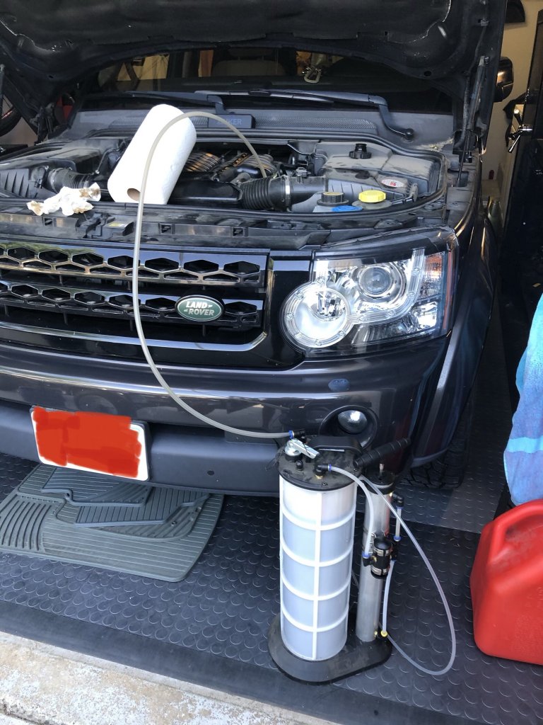

An update on my LR4 I did the oil with the mighty vac and got a chance to look a least one of the chains. Everything in there looked very clean with no brown burn. I tugged on the chain with a tool and it seemed pretty taught. I got all 8 liters out so to this day I’m not sure what that sound was but it has not returned. I’ll chalk it up to cold weather.

You do know that most if not all dealers use a vac system to change the oil. Have they been charging you for drain plugs and washers?
I forgot to reply to this. At JLR Thousand Oaks they would pull the pan bolt. I did have it serviced once at Fresno but I do not know if they pulled it. The other 2 times it’s been changed I’ve done it.
1,403
Interesting as the JLR dealers I have been to have a fancy air driven draining system. I guess if they are doing and charging for an inspection they may pull the bolt. Usually it is a functioning crack head one step above lot boy who is doing the lube/oil/filters though...
