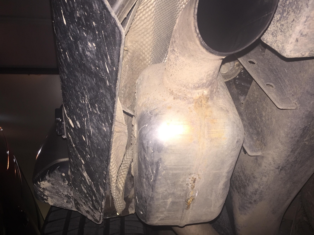

DSM, can you post pics of the underside of the bumper? Is there a tie in to the frame on the outside sections?

Here is a photo of the bottom of the bumper under the muffler, it does not attach to the frame like the kaymar design.
I did have to bend the heat shields and trim the back of the wheel well liner to make it all look clean...

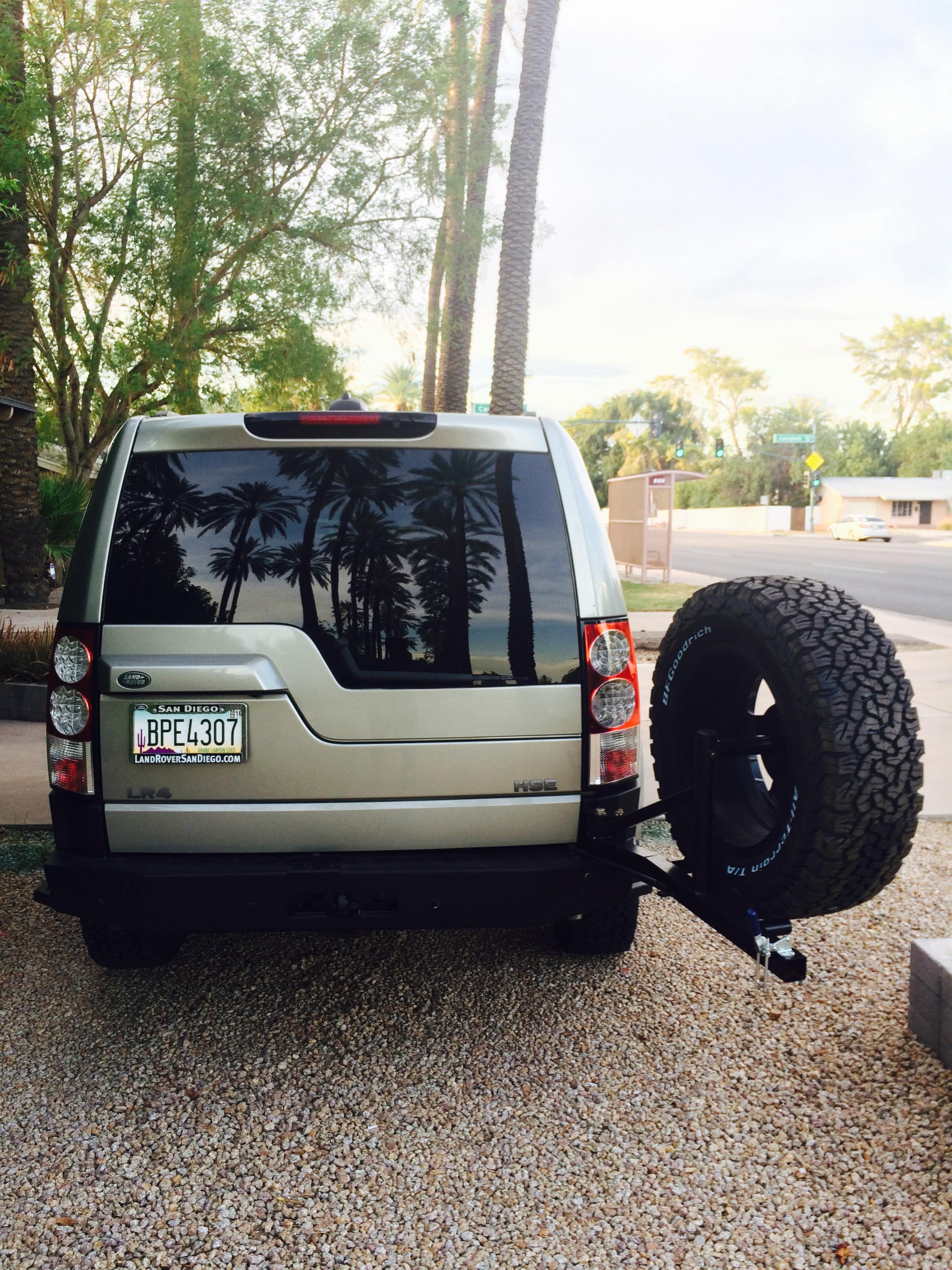

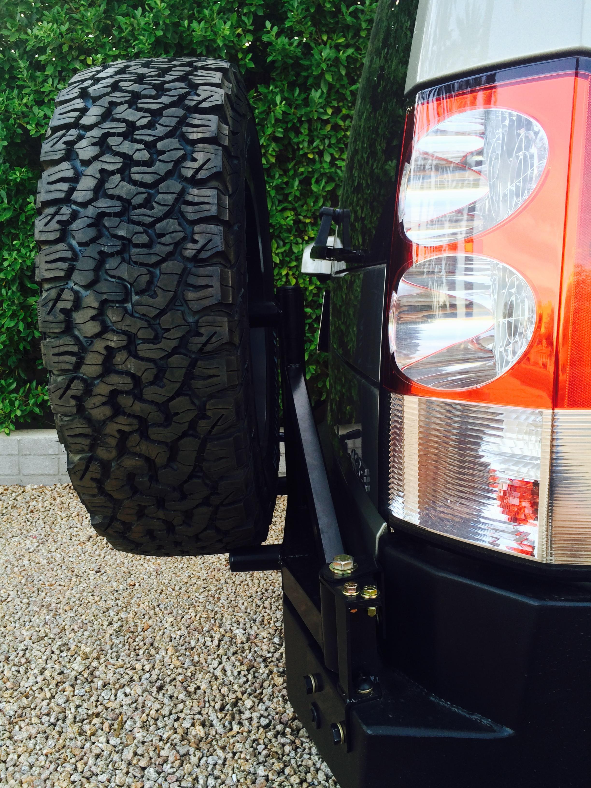

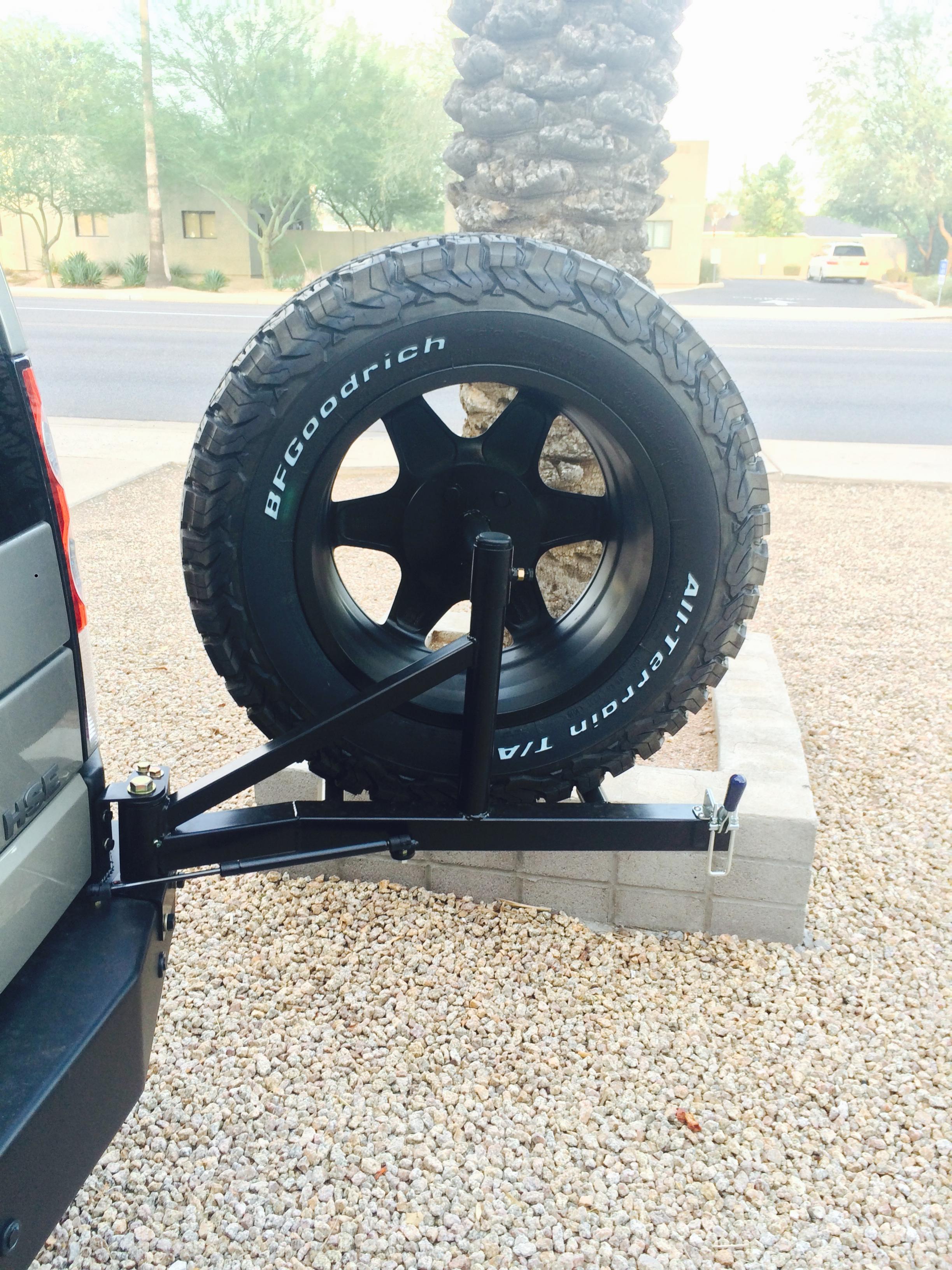

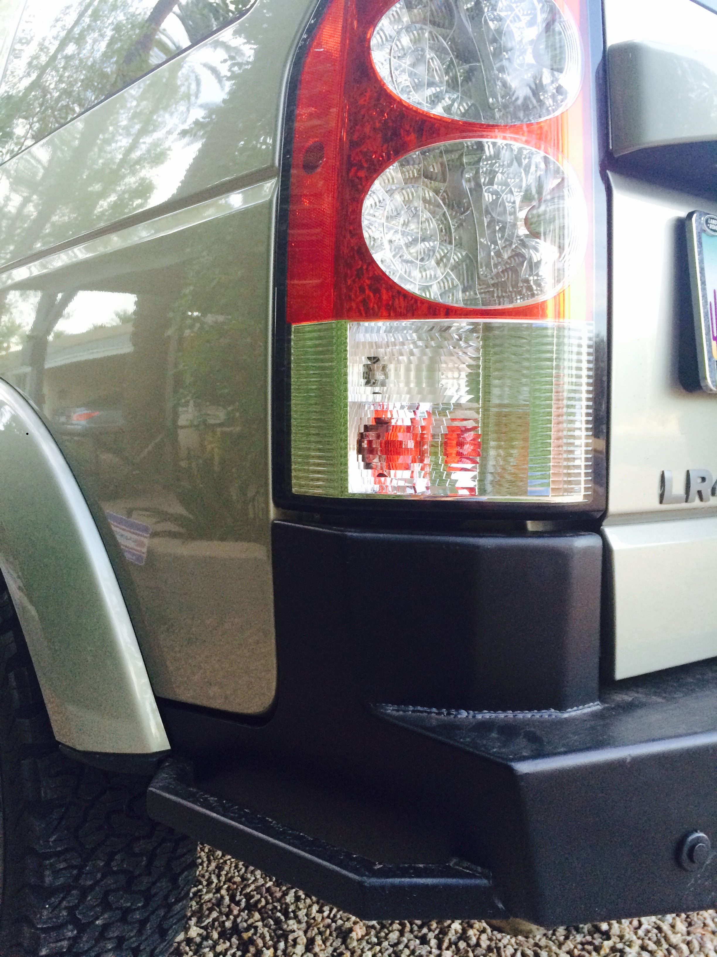

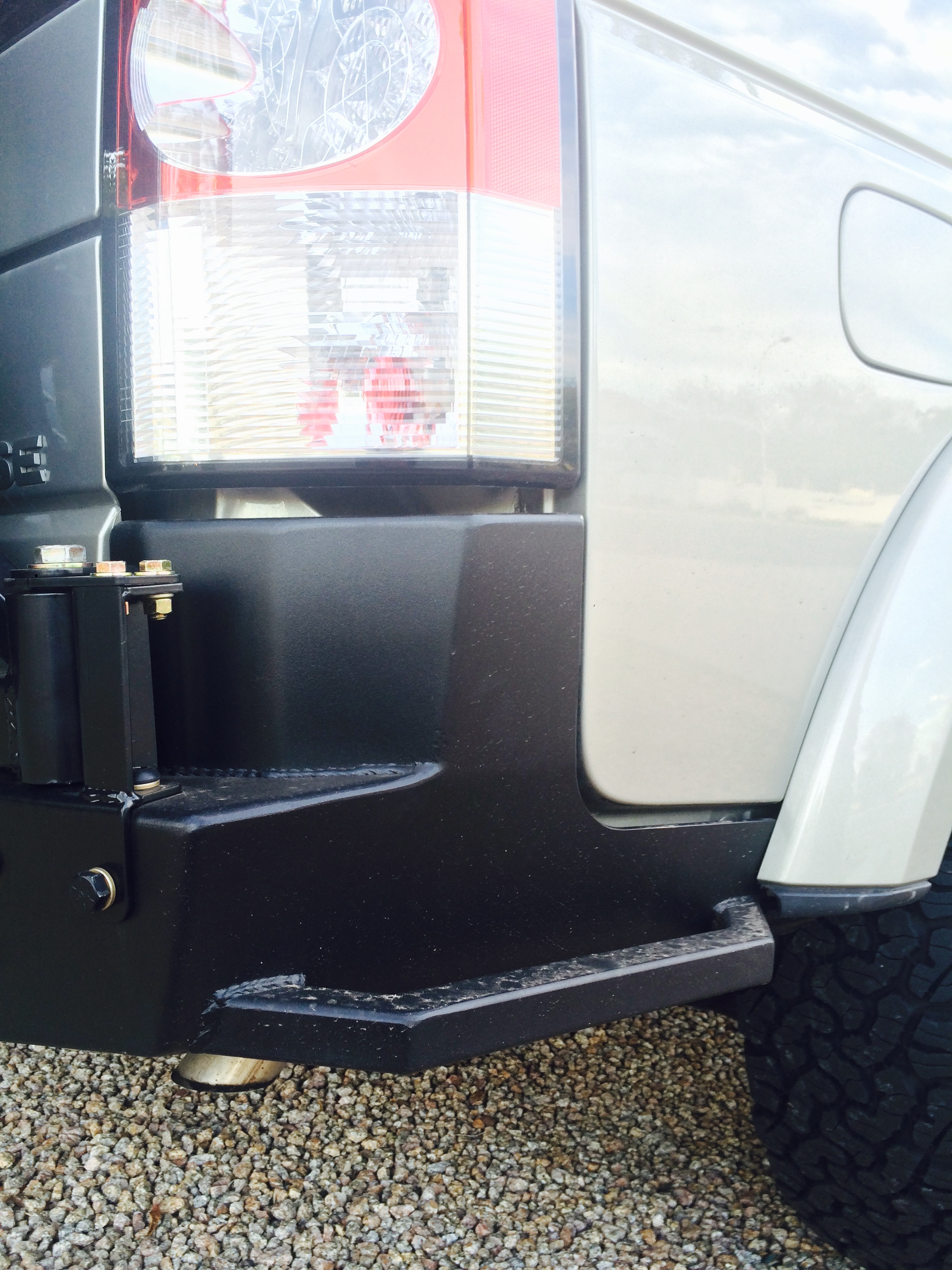

So this is my Disco4 with the bumper installed. I have the same issue as dcorn.

Sorry man, that is a drag, what did Sierra say about fitment? I'm sure they probably tried like hell to get it level or close that gap. I am in a 2010 LR4, not sure what year you guys are in.
I installed mine on my garage floor with a floor jack following Eric's instructions...
I started the driver side nut without either washer to pull it tight then installed the passenger side with washers, brought it tight and then added washers to pasenger side...
Does the spare impact your parking sensors?

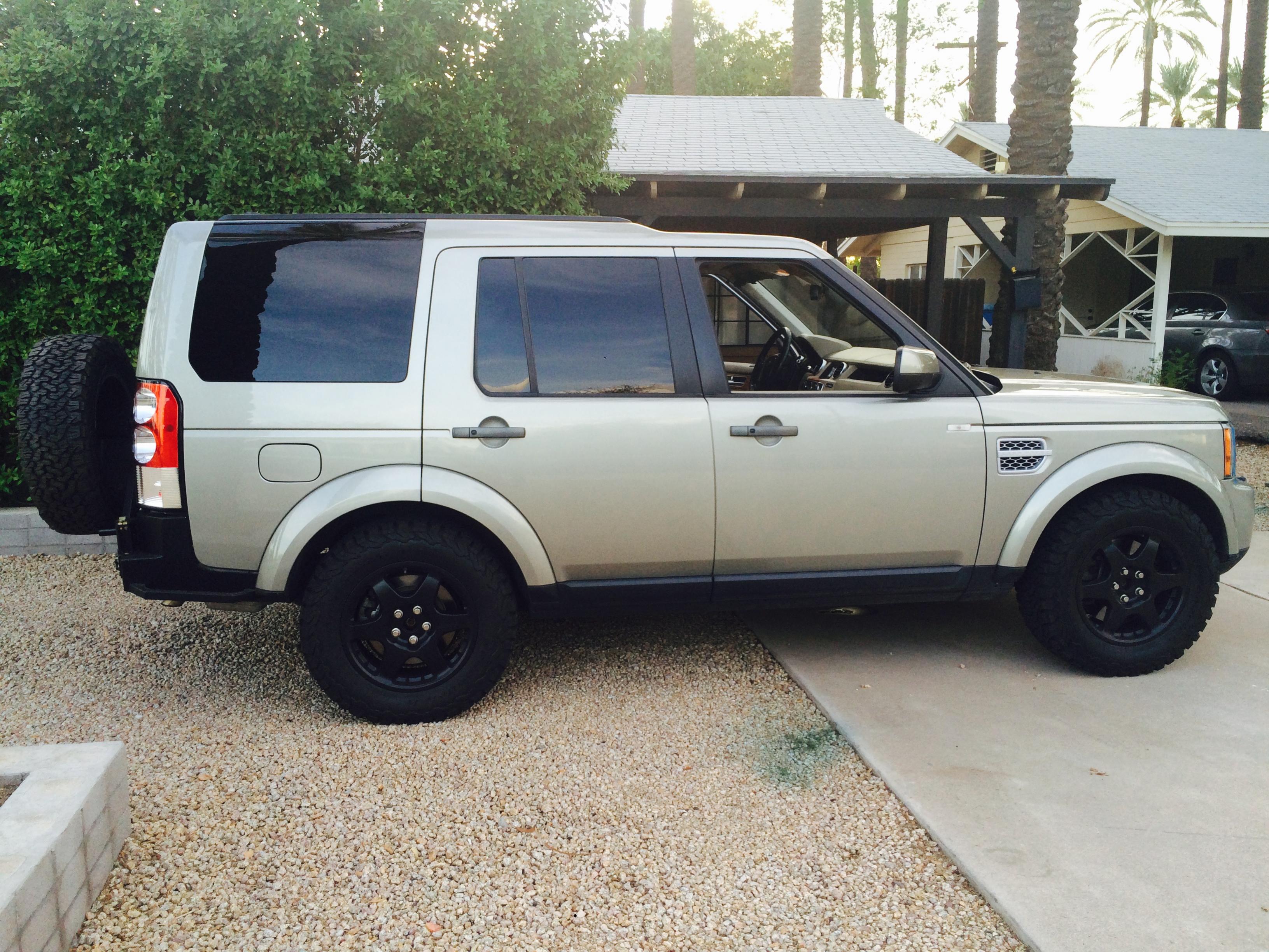

Also, that looks like your truck is ipanema sand like mine, can you post a side shot of it (want to see what it looks like with compo's on it)

Sierra Expeditions did the best they could with Eric's instructions also. It's off a bit but not as much as yours. I can deal with it for now until I can ask them to try and level it off more. I don't have tools or a large to work in.

And yes, my Disco is in Ipanema Sand. I've ordered a ProspeedUK roof rack system for it a few weeks ago and just waiting for it to arrive and have it installed. I plan on having my vents and grill painted black, possibly my wheel arches also. And I'm looking into buying a Black Discovery 4 badge for my rear and Landrover for the bonnet. I'll post more pics of her when she's done.

It is funny about that gap. I have the same issue on the Kaymar and no matter how much I shim I can't get it equal.
