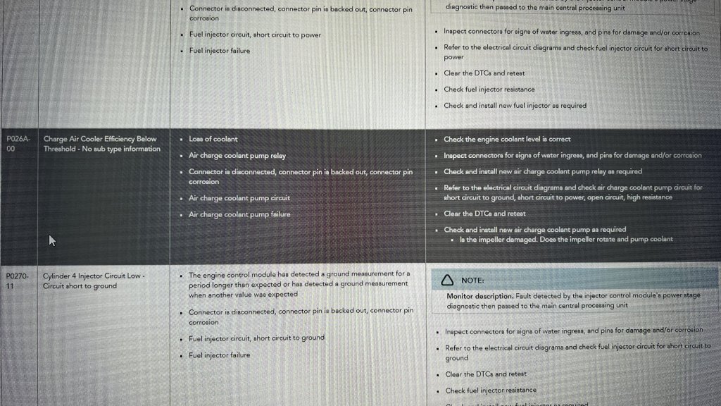

Great info, I’ll check these items out as well.
Attached photo is what Topix attributes the P026A code to and what lead my down the aux pump path.

greiswig

FWIW, I would lean on the wisdom of this forum and people like jlgr4, ryanjl and a few others before Topix. More specialized, germane wisdom here.
