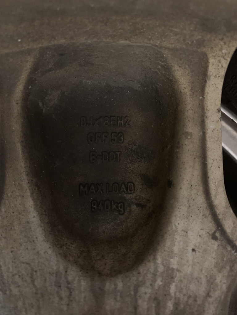

So with your experience would you say this wheel would fit. This is from a LR3 8JX18 EH2 off 53
1,858
No.
Not without either a 1.25" wheel spacer or grinding the hell out of your front brake calipers.
yeah 75 to 53 isn't enough. I think the compomotives work because they are machined or cast with more clearance where it's needed but also their offset is 44 and it's barely enough but only as much as needed.
You have to keep in mind when looking at parts sources that even if it's a factory item, the europe market made use of smaller wheels as well as larger because there you could order a base lr4 with lesser engine and brakes or a 5L w big brakes.

Well, first, you are totally confusing tire size with wheel size. Then, you add a bunch of information about tire size that's useless to determining whether a wheel fits over a brake caliper.
Anything that fits on one unmodified LR4 should fit on another. What wheels was it you bought?
It's not that hard to find information on what 18 inch wheels for sure work. It's really easy, in fact. Your choices are:
Compomotives.
Mudtechs.
Or, LR3 wheels with a 1.25" wheel spacer.
For wheels, yes, for total solution one can also put on lr4 tdi spec brakes i would assume just as I swapped in the V6 gas matched brake size.
You probably also know Ryan but the NAS market briefly got just a few lr3 in v6 form and those came with factory 17".
If it were me setting up an lr4, it would be the compomotives or brake rotor size swap to also allow 17" - and that's what I would in reality do because I have the 17" set of 5 studded for winter.
Being 1" narrower at 7"x17" though it's also a killer choice for a tall BFG km2 or similar in 255/80x17
