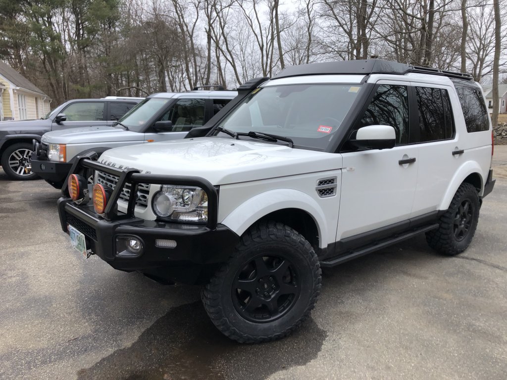

275/70R18 MT TA KM3... Makes me happy. Terrific tire, extremely quiet on road.

275/70R18 MT TA KM3... Makes me happy. Terrific tire, extremely quiet on road. View attachment 9341
@NASdiesel
Glad to hear that about the KM3. I'm planning on that size/model being my next tire.
Are those TR sliders? Any issue with that size rubbing on the slider? That is my only remaining concern with that tire size.
Wait a minute, that is an LR4, correct? Or did you update the front end of a LR3?
I see a snorkel....if it is a 4, what did you do with the driver's side air intake????
