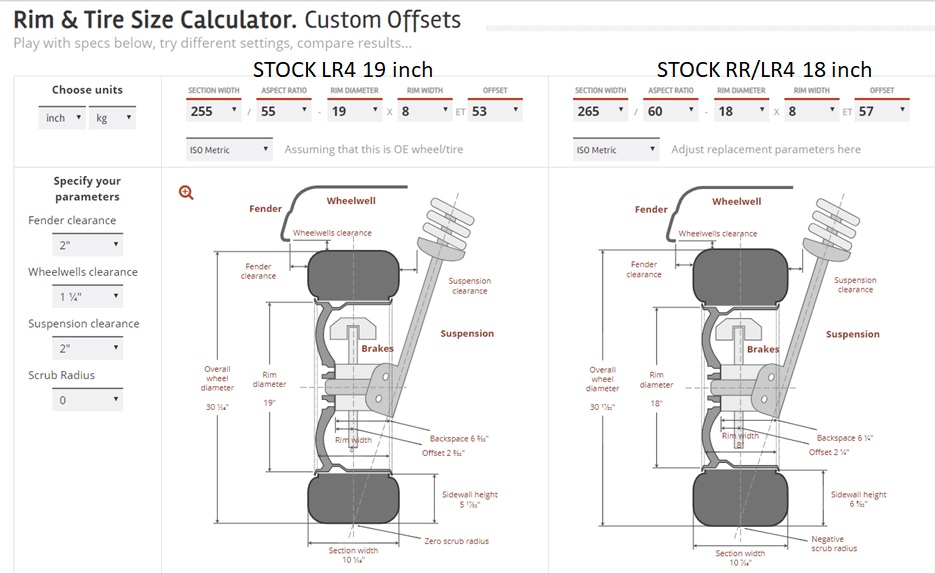

OK I feel like I'm banging my head against the wall. I've tried to take in all the information here and not ask stupid questions. I ended up going with an 255/60R18 8Jx18 AH2 ET57 inch wheel I purchased from a LR4 driver, I have a 2016 SCV6. It didn't fit.. it was rubbing on the caliper.
I'm going crazy.

1,858
Well, first, you are totally confusing tire size with wheel size. Then, you add a bunch of information about tire size that's useless to determining whether a wheel fits over a brake caliper.
Anything that fits on one unmodified LR4 should fit on another. What wheels was it you bought?
It's not that hard to find information on what 18 inch wheels for sure work. It's really easy, in fact. Your choices are:
8Jx18 AH2 ET57 - I have worked out that it is the ET57 (offset that was the problem)
1,858
What wheels are those? A google search turns up nothing.
Just so you know, 18" wheels were not offered on any LR4.
