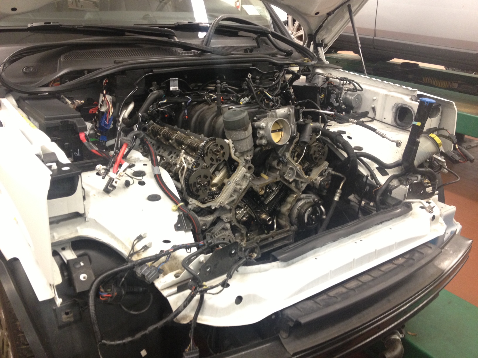

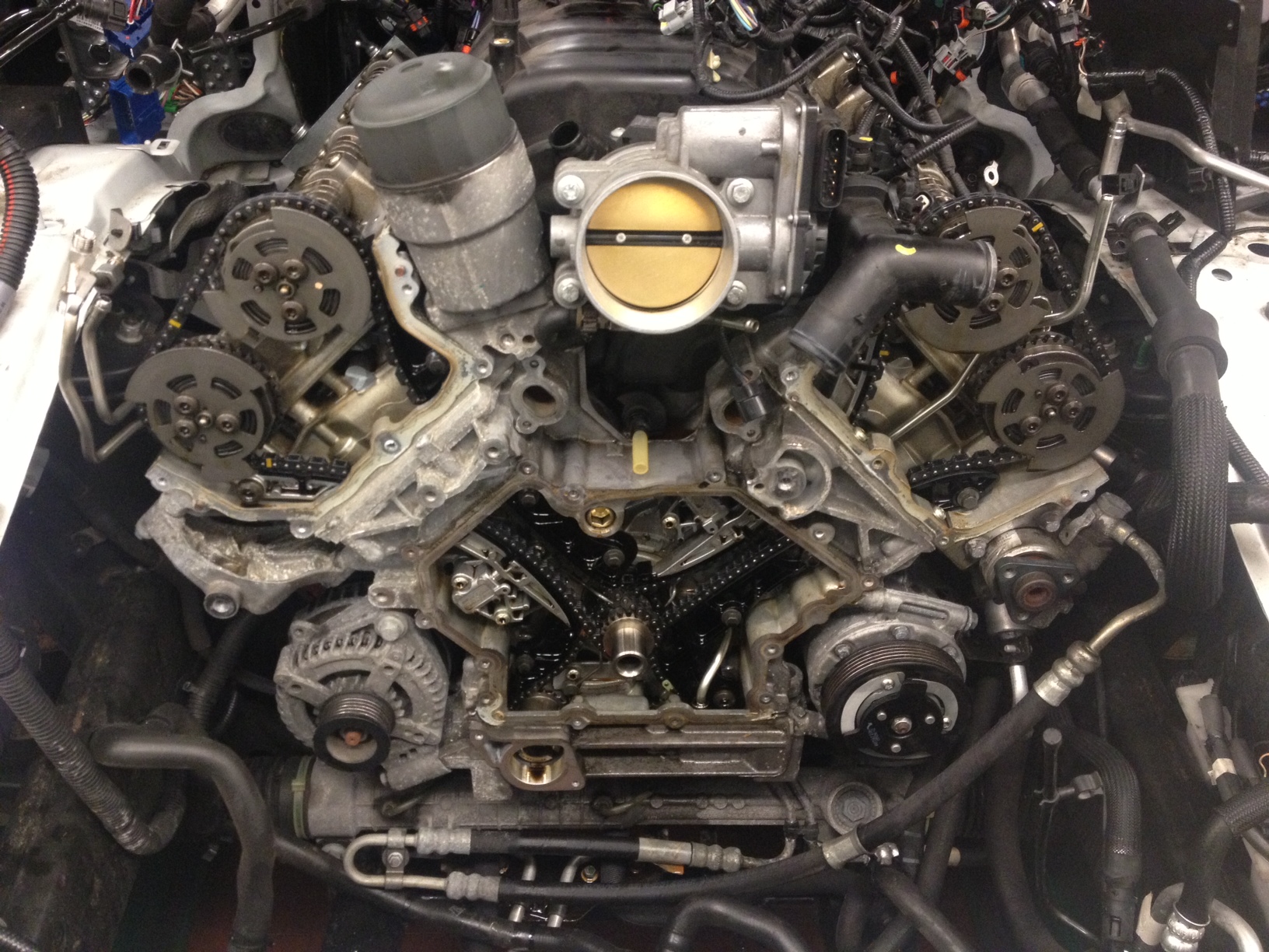

Just had the "Restricted Performance" warning come up on our 2011 LR4 w 59,000 miles. Dealer says small metal shavings in oil and error code indicates timing chain tensioners and rails replacement is required. Quoting me $5800 for the job. This seems insanely expensive, but then again I always feel like I'm getting ripped off. What are my options ?
The whole front end of the vehicle, and the engine, has to come off to access timing chain/guides/etc.

My LR4 had the same problem. An issue with the guides causes the timing chain to not be as taught as it should be. The excessive slack cause the chain to make noise. It also changes the engine timing, which is why the "Restricted Performance" light turns on. I don't believe the parts are overly expensive, but the job is labor intensive. I would shop Land Rover dealers for the repair. They don't all charge the same.
We have just gone through this with our '11 LR4. VVT, timing chains, etc. Took a week to fix it. Luckily we got it in just before the warranty expired! Sometimes (but not often) I'm just lucky.
