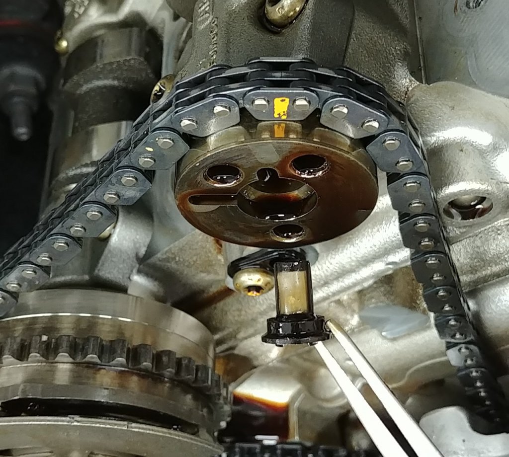

The first couple times I just pulled the pin and press as hard as I could but no click. The blades could still be moved back a little. I thought this was acceptable as oil pressure would provide additional tension when the engine was running. But every time I would manually turn the crank, the chain would jump.
I'll try the c-clamp idea. Haven't reinstalled the tensioner yet. Need to disassemble the vvt and clean the filter. The oil that was dripping out of there was pretty dirty and sludgy. And I just did an oil change less than 1,000 miles ago.

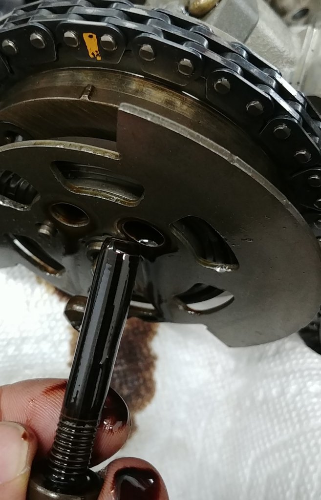

Filter looks ok, but the oil is nasty... Thick and super dark.
Makes me think there's a circulation problem. 20191119_193255~2.jpg 20191119_194216~2.jpg

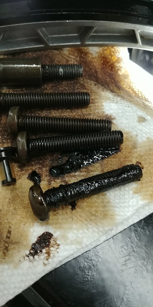

More frequent oil change maybe the best way to combat this timing issues. Even with the updated tensioner and blade on newer vehicles, I think the overall system suffers from lack of oil flow. Old oil seems to accumulate in certain components and allow to cook and build up.
These are cam sprocket screws.
Look at all that tar.

ignorance is bliss man! Why’d you have to go and show us that? Lol. I like thinking my 5k oil changes keep things from looking that way in there...now I’m not gonna sleep
