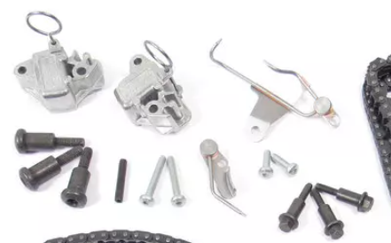

Can somebody confirm if the passenger side chain and the driver side chain are the same; I imagine they are (given the physics) but I'd like to be sure (part LR032048). Same question for the tensioner (the hydraulic/spring tensioner) (part LR095472) and then again for the guide (the aluminum part) (part LR051013)?

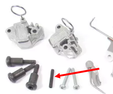

In the Atlantic British kit; what part is this (red arrow is pointing to it):
British Atlantic also seem to sell the oil timing chain parts as well; is this something that really needs to be changed? Is this simple or another can of worms?
Thanks as always.

I'll answer my own questions based on more research and getting comfortable with this...
"Can somebody confirm if the passenger side chain and the driver side chain are the same; I imagine they are (given the physics) but I'd like to be sure (part LR032048)"
They are the same, on my shopping expedition I found a few sites that clarified this.
"Same question for the tensioner (the hydraulic/spring tensioner) (part LR095472)"
Same answer, they're the same
"again for the guide (the aluminum part) (part LR051013)?"
Same, this however is the metal guide that causes the timing issues (metal lined with some sort of nylon), the plastic guides are not identical (parts LR051011 (right) and LR051012 (left))
The pin shown above is the guide pin for the auxiliary driver (part LR011063).
