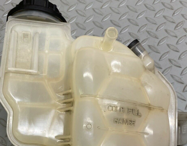

What is best practice for checking coolant level; both when the engine is hot and cold?

AFAIK you just want to have the truck on a level surface, and check it cold. Pretty sure the reservoir only has a marked level range for cold? Dunno if there is any valid "hot" test. (??)

Thanks. In that case I'm good...or at least as good as any Landy owner can be at a given point in time. My overnight cold level was exactly in line with the lower line in the cold fill range.
