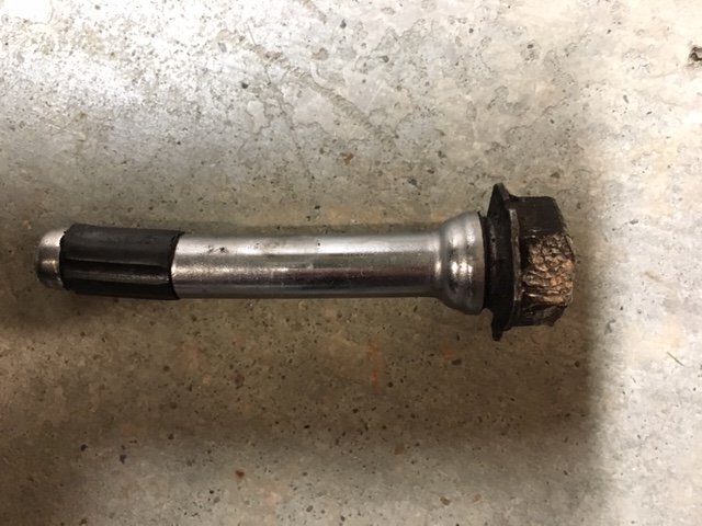

Yes there are bushing front and rear. In the end it may not matter if they are on the top or bottom but LR specifies bottom so that is where I put them. The key is proper lube so the bushings do not swell and/or lube dries out. Silicone only. Otherwise a simple brake job turns into this:
