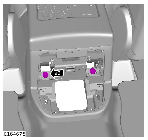

Remove coin tray and vertical cover at rear of console. Remove two screws. Unplug connector.

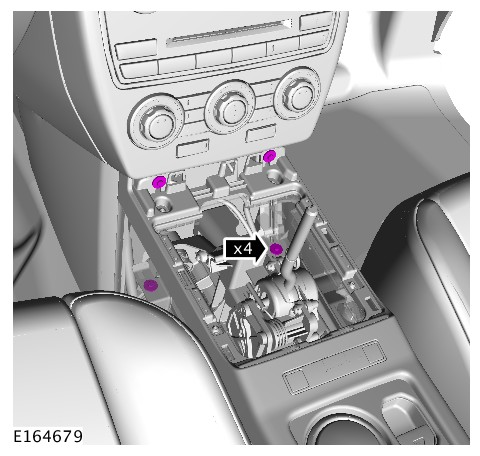

Remove purple bolts.

I took out the purple bolts also....
I had a hell of a time getting that sucker replaced!
I thought I could just take off the top portion and turn it upside down and replace the switch , ended up having to take out the dash that houses the radio display and removing the climate control assy unit , I found 2 bolts at the rear inside of the panel you had to remove that holds whole console close to floor. I was then able to lift the whole console assy from the rear towards the front just enough to lift the front of the console and replace the switch without having to disconnect any wires assy connectors.
