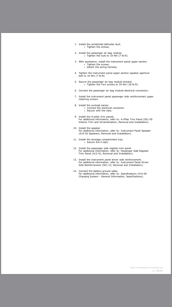

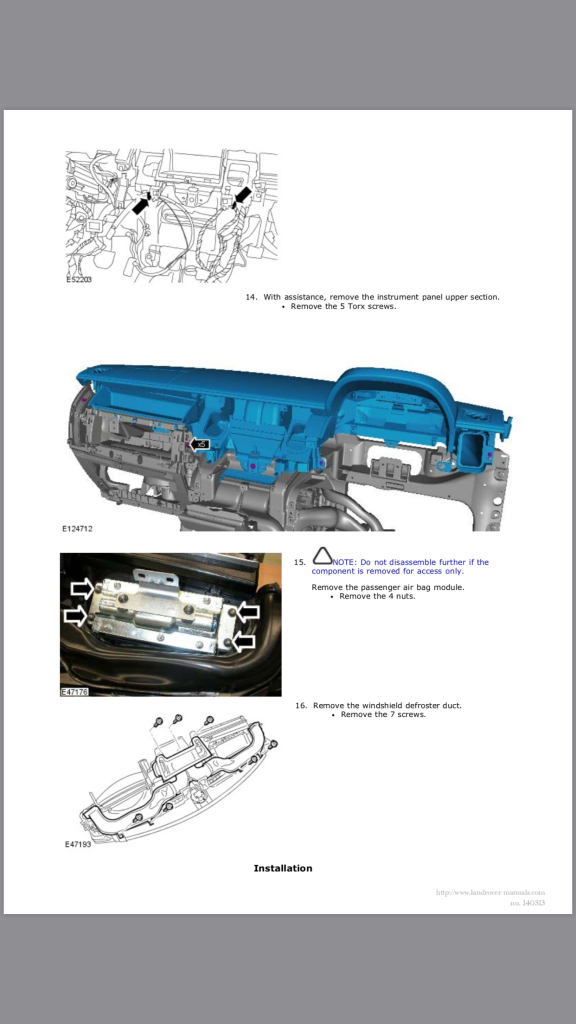

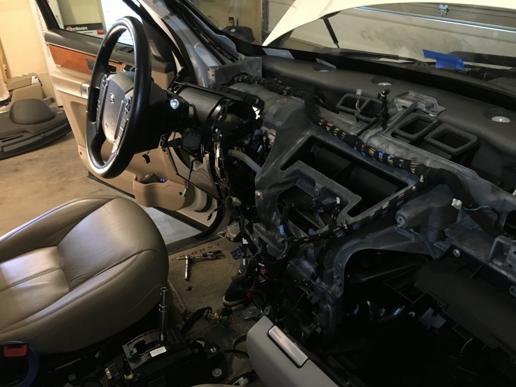

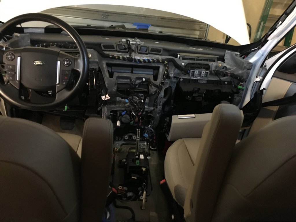

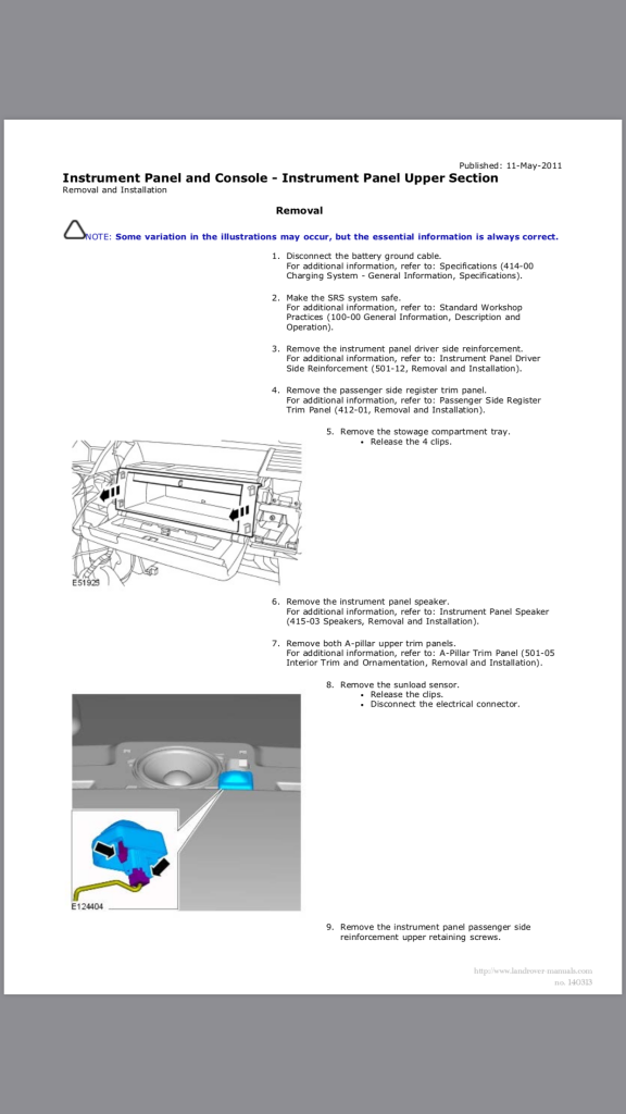

Well, I got it all out. Planning to order parts tonight. I hope I can get it all back in the right way when they get here!
Thanks catman for suggesting the new parts site. Turns out, the new one is cheaper than the used one.
Thanks Felix also for the service manual pages. From that, I was able to find all of the steps to remove what was needed. As you can see, removal of the steering wheel and the passenger dash reinforcement was not necessary.
