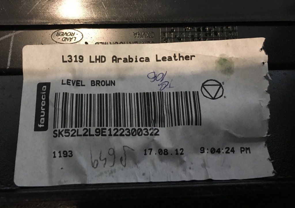

Ok, so the saga continues. I get a call today from Land Rover Merriam that the part they listed as fitting my LR4 does not, in fact.
Are there any parts gurus out there that can tell me the difference between these two part numbers?
LR044209
LR044343
Only distinction I can find is the 209 is without limited edition. But I don’t know what limited edition really means.

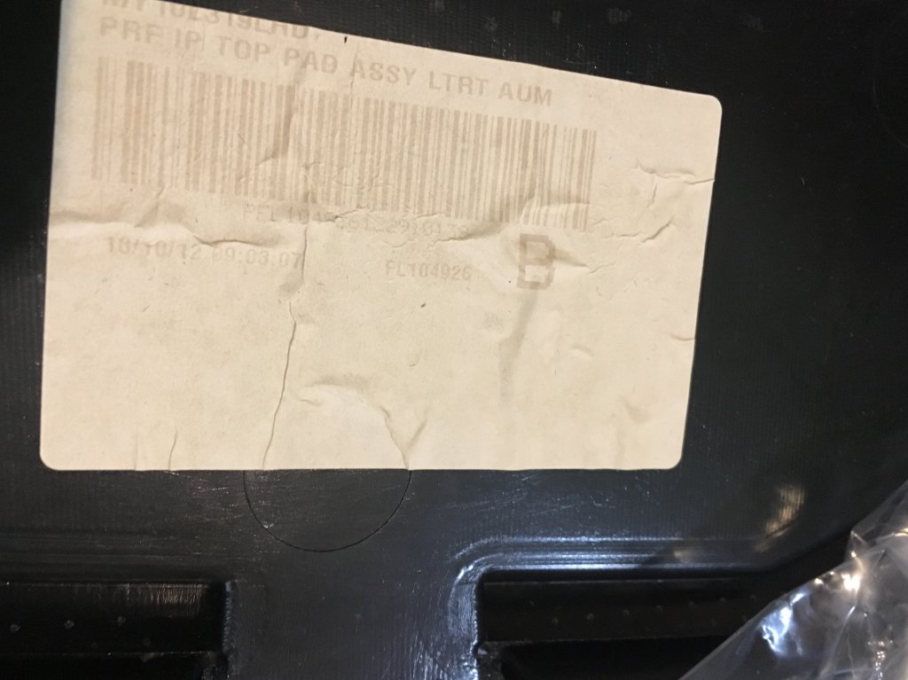

I inspected for obvious damage as to why the leather was peeling. I didn’t look for a number because I already had the parts ordered lol.
I’ll look more closely for a number when I get home from work.
Doing more searching I found that LR made a non-leather covered dash. The leather was part of an extended leather option.
The parts guy at Merriam said he sees LR4 dash problems all the time.

I looked all over the underside of the dash panel, and all I can find are some stickers that ID the part, but not by any part number we would know. It looks like Faurecia's part numbers.
