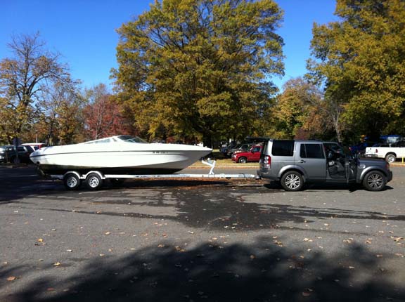

This past weekend my wife and I pulled the boat for the season. We purchased our LR4 this past summer so this was the true test. I have pulled my boat and trailer with my brother in-laws Disco II. The shorter wheelbase made it for a rough ride and lots of transmission 'hunting'.
My boat and trailer combo weigh in at 6600lbs (24' boat with 454 Mag MPI engine and 60gal tank). I'll admit, I was a little nervous with the LR4/RRS quirky receiver hitch setup. Our LR4 pulled the boat without hesitation. A slight tap on the gas and we got right up the launch ramp (w/o low range). We hauled it through the city and highway and it was smooth across the board. No transmission 'haunting" and plenty, I mean, plenty of power! I have attached a pic of the rig:

That's pretty amazing, testiment that the LR4 is truly amazing.
Daniel Hull
Apr 9, 2011
54
What is the tongue weight of that rig? With a limit of 550 lbs, it would seem likely you would be exceeding the spec.

I don't know the exact tongue weight but I'm sure its under 550lbs. Most of the weight (engine, drive and fuel tank) is at the stern of the boat and over the tandem axle.
I can see that camping trailers would have a increased tongue weight because the amenities can be spaced throughout the trailer.

If your boat / trailer combined weigh in at 6600 pounds like you said, then your tongue weight should be over 550 pounds, since ~ 10% is recommended.

Trailer Boat Magazine finds that boat trailers are typically in the 5-7% range. Boats are almost always stern heavy. So I would have to agree with TBM. A true way to get the weight is with a scale and fulcrum method. If you exceed the percentages, you can adjust the trailer winch forward or back to get to the desired number. In doing so, you want to evenly displace all the weight over the tandem axle without too much weight over one axle.

My 20' Larson with a full tank of gas, trailer weight and all the misc. extras weights around 5800#. My trailer tonge weight is roughly 400# (scale on trailer jack). So I will agree that 10% is on the high side of the assumption. PS I get about 13 mpg on hwy pulling the boat doing around 65 mph.
