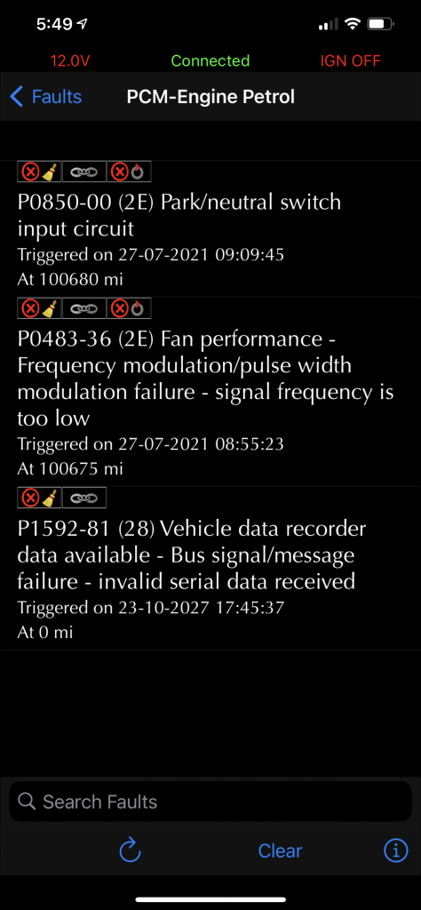

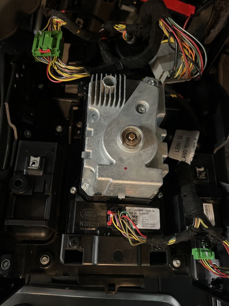

I have had the P0850-00 code and a shifter that stays in the elevated position for while. Cruise control has not worked properly in a while. I was able to put the car in N, clear the codes, put in parking brake, turn off the car, turn it back on and drive off and be able to use cruise control every time. Which is super annoying. That basically avoids putting it into P and getting that error. Anyway I ordered a new (used) TCS on eBay and will install it this week. Hopefully that rights the situation. Not sure if one of my kids spilled something into the old one or what. I disassembled it and the circuit board looked fine no burnt traces. The lift motor is dead but the part isn’t that expensive so I just got another one.
