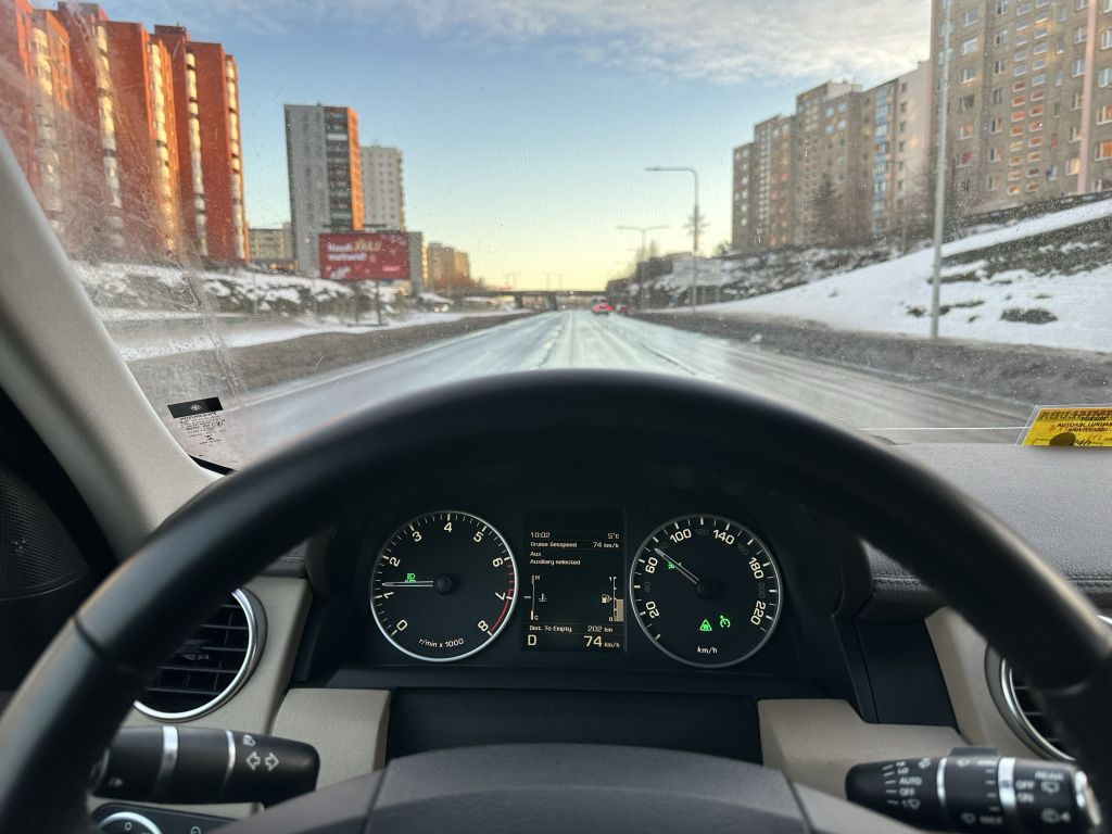

ACC working with 2015MY and this MY should have ware loom under front bumper.
Also you need Radar for 15MY FH22-9G768-AE should work, for 14MY I believe need BH32-9G768-AD like in RRS and Bracket for radar LR062475 but you can use LR060076 with some modifications.
And of course you need steering wheel switch as you said and modify CCF.
- btw, It's possible run ACC on 14MY but it will be harder. Also it's possible on older MY but only with specific CAN adapters.

And about price – I bought buttons (with steering wheel ) and radar only for 300€ ($330) but as proof of concept I used not cheap CAN device developed for specific task – not for ACC

iSheeZ
Nov 14, 2021
31
19
Estonia (EU)

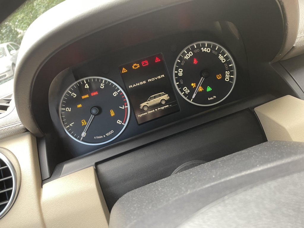

@iSheeZ I looked into this myself, and my understanding is that it is not possible on the MY2014 without extensive work. There's a fairly lengthy thread about retrofitting on the disco3 forum. Basically the v8 cars require a radar module + separate ACC module + button. In 2015/16 its just a more advanced radar module and the steering wheel buttons. I talked to GAP about the 2014 and they indicated the code for the ECU did not include ACC, and that if the ECU were updated, a number of other modules would have to be replaced. Again, no first hand experience, but what I picked up while looking into it myself.
iSheeZ
Nov 14, 2021
31
19
Estonia (EU)
As I know, all ECU have ACC control and main problem – it's radar firmware because this thing doesn't know "what is LR4/Discovery 4". If your LR4 will be RRS – it should work ;)
